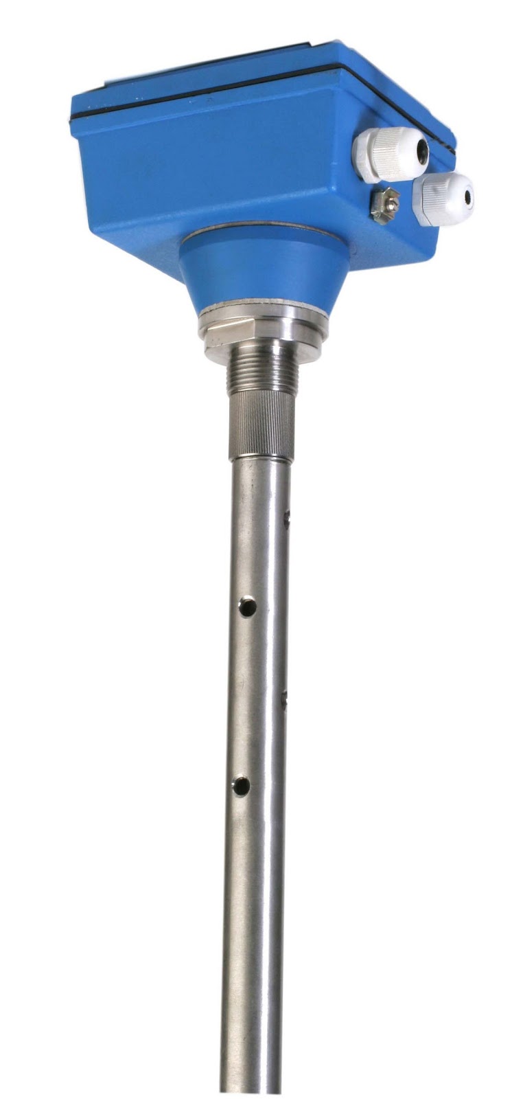

Generally, one thinks of a capacitor as having two small parallel plates separated by air or another type of dielectric. For capacitance level measuring applications, however, one plate is a probe while the other plate is comprised of the tank of the level vessel ( see figure of capacitance below ). The dielectric is the material in the vessel which will determined the capacitance value when it rises and falls. The liquid in the tank will be measured by the capacitance measurement meter. Capacitance level measurement probes are mostly used in on /off applications for alarms or switches and control functions. For such applications, the probes can be mounted horizontally, perpendicular to the level surface, so that a large plate area is effectively used.

Generally, the capacitance values of a probe should be high compared to the capacitance of the lead wires connecting it to the measuring circuit. The wire capacitance should be swamped by the
probe capacitance variations. Otherwise, instability and erratic operation may result.
