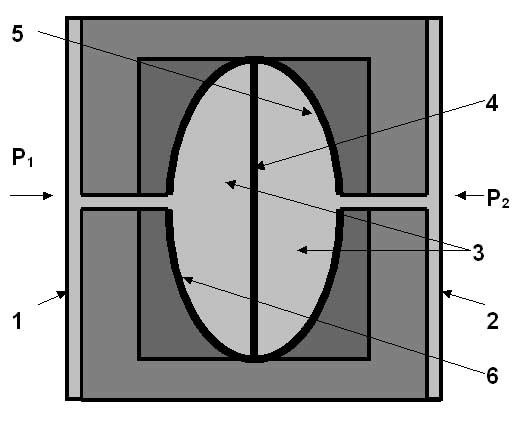

Fig. presents a transducer for sensing and transmitting differential pressure. Pressures to be measured act on isolating diaphragms 1 and 2 and are transmitted through a silicone oil 3, which fills the system, to a sensing diaphragm 4.
This sensing diaphragm is balanced by two forces developed by measured pressures and presents the sensitive element.
Capacitor plates 5 and 6 detect the position of the sensing diaphragm, which moves to the left or to the right, and, thus, the differential pressure applied to the sensitive element.
The change in electric capacitance is electronically amplified and converted to the standard electrical analog or digital output signal, which is directly proportional to the difference of pressures.
In order the capacitance transducer be able to measure comparatively low pressures, the device should produce about 25% change in capacitance for a full-scale pressure change.
These transducers have low mass and high resolution. However, they are slightly dependent on temperature variation. Newly developed all-silicon capacitive pressure sensors have better thermal stability.
