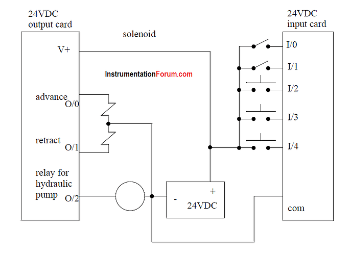

An electrical layout is needed for a hydraulic press. The press uses a 24Vdc double actuated solenoid valve to advance and retract the press. This device has a single common and two input wires.
Putting 24Vdc on one wire will cause the press to advance, putting 24Vdc on the second wire will cause it to retract.
The press is driven by a large hydraulic pump that requires 220Vac rated at 20A, this should be running as long as the press is on.
The press is outfitted with three push buttons, one is a NC stop button, the other is a NO manual retract button, and the third is a NO start automatic cycle button.
There are limit switches at the top and bottom of the press travels that must also be connected.
Press Wiring in PLC
The input and output cards were both selected to be 24Vdc so that they may share a single 24Vdc power supply.
In this case the solenoid valve was wired directly to the output card, while the hydraulic pump was connected indirectly using a relay (only the coil is shown for simplicity).
This decision was primarily made because the hydraulic pump requires more current than any PLC can handle, but a relay would be relatively easy to purchase and install for that load.
All of the input switches are connected to the same supply and to the inputs.
