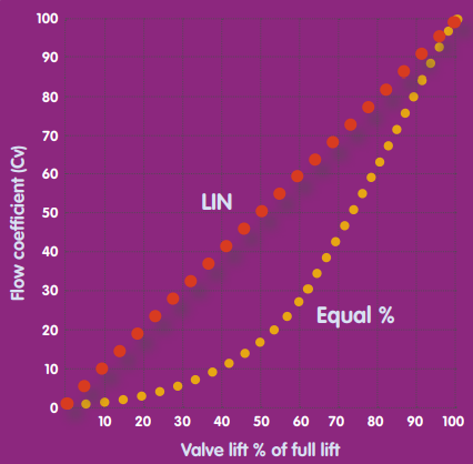

The Inherent flow characteristic of a control valve is the relationship between the flow and the lift of the plug at a constant pressure drop.
The characteristic normally available, are shown.
Linear - Flow is directly proportional to valve lift.
Equal % - Flow changes by a constant percentage of its instantaneous value for each unit of valve lift.
