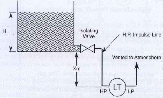

Zero Suppression:
In some cases, it is not possible to mount the level transmitter right at the base level of the tank. Say, for maintenance purposes, the level transmitter has to be mounted X meters below the base of an open tank.
The liquid in the tank exerts a varying pressure that is proportional to its level H on the high-pressure side of the transmitter. The liquid in the high pressure impulse line also exerts a pressure on the high-pressure side. However, this pressure is a constant (P=S.X) and is present at all times.
When the liquid level is at H meters, pressure on the highpressure side of the transmitter will be:
Phigh=S.H + S.X + Patm
Plow=Patm
P=Phigh -Plow=S.H + S.X
That is, the pressure on the high-pressure side is always higher than the actual pressure exerted by the liquid column in the tank ( by a value of S.X). This constant pressure would cause an output signal that is higher than 4 mA when the tank is empty and above 20 mA when it is full. The transmitter has to be negatively biased by a value of -S.X, only. This procedure is called Zero Suppression and it can be done during calibration of the transmitter.
