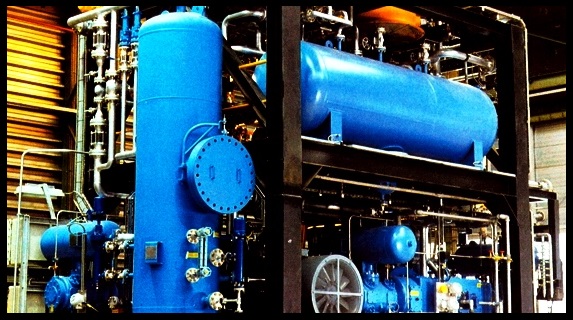

Following routine maintenance at a processing facility, the first and second stages of a compressor were severely over-pressurised during de-isolation. In the ensuing efforts to rectify the situation, operations personnel were exposed to a risk of a catastrophic failure of equipment and being enveloped by a gas cloud.
What went wrong?
During maintenance work the compressor was isolated from a common gas export header via a double block and bleed arrangement. The bleed line had been used to depressurise the compressor prior to the high pressure flare header being isolated.
Following maintenance, the de-isolation process was commenced by opening the valve to the gas export header without realising the bleed valve was still open. As a result, the pressure increased along the pipework downstream of the pressure safety valve up to the isolating valve on the flare header.
At the same time, gas flowed through the blow-down and recycle valves to the first, second and third inlet sections of the compressor, which were open following de-energisation of the system. This was partly due to pipework modifications made in the 1990’s which allowed high pressure gas to back-flow into the low pressure first stage suction side of the compressor.
The valve isolating the high pressure flare header was then opened slightly and an unexpected gas flow was noticed that started to ice up this valve. During the process of investigating the unexpected process conditions, a request to undertake another task was received.
Before leaving the compressor area to undertake this new task, the valve flare header valve was closed, allowing the pressure to continue building up at the compressor inlet. Before the de-isolation process could be resumed, a flange and a seal on the compressor burst resulting in a gas leak, and triggering a gas alarm and plant trip.
Due to concern about the icing up of the flare header valve, three operators proceeded to the compressor and vented the pressure through scrubber vents. The first stage scrubber was pressurised to almost four times its normal operating pressure so that a catastrophic failure of equipment and associated rapid release of a gas cloud could have resulted.
