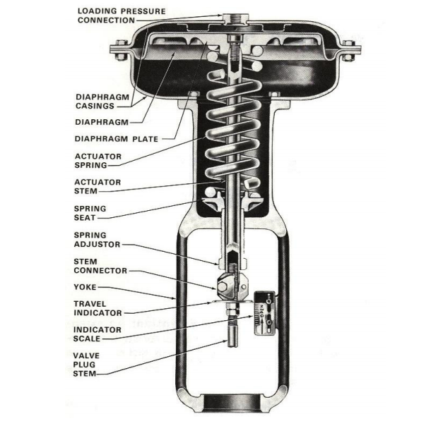

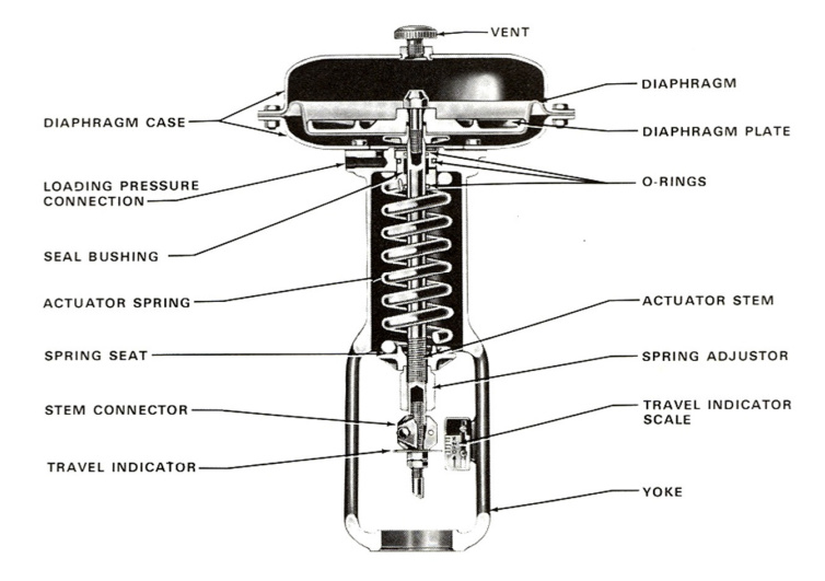

The operation mechanism of an actuator can be direct acting (Figure 1) or reverse acting (Figure 2). The spring and diaphragm pneumatic actuator is most popular due to its dependability and simplicity of design.

Figure 1: Direct acting diaphragm actuator
Figure 2: Reverse-acting diaphragm actuator

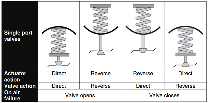

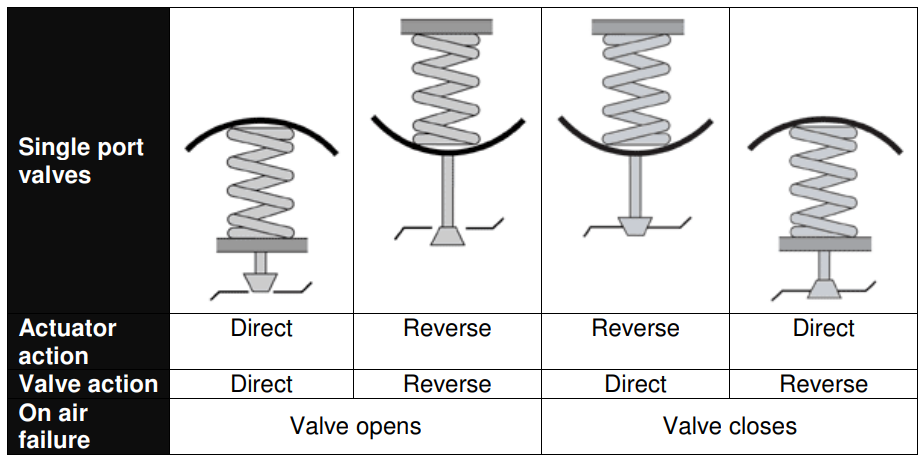

The choice between direct acting and reverse acting pneumatic controls depends on what position the valve should back to in the event of failure of the compressed air supply.
This choice depends upon the environment of the application and safety requirements. It makes sense for steam valves to close on air failure, and cooling valves to open on air failure.
Table 1: Effect of the choice valve and actuator action for single port valves

Direct acting - increasing air pressure pushes down diaphragm and extends actuator stem;
Reverse acting - increasing air pressure pushes up diaphragm and retracts actuator stem;

Net output thrust of diaphragm actuators is the difference between diaphragm force and opposing spring force. Molded diaphragms are used to provide linear performance and increased travels. Size is dictated by output thrust required and supply air pressure available. It is simple, dependable, and economical.
