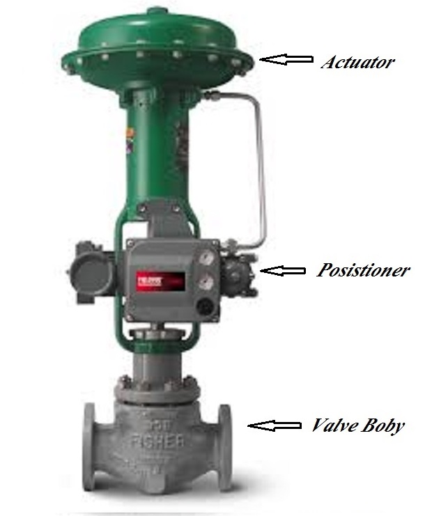

A control valve consists of three main parts in which each part exist in several types and designs:
Valve’s actuator - The opening or closing of control valves is usually done automatically by electrical, hydraulic or pneumatic actuators.
Valve’s positioner- Positioners are used to control the opening or closing of the actuator based on electric, or pneumatic signals. These control signals, traditionally based on 3-15psi (0.2-1.0bar), more common now are 4-20mA signals for industry, 0- 10V for HVAC systems, and the introduction of “Smart” systems, HART, Fieldbus Foundation, and Profibus being the more common protocols.
Valve’s body - valve bodies are available to achieve specific flow regulation behavior of process fluids.
