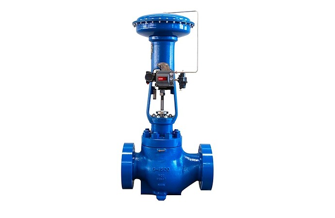

1. What is a Control Valve?
A control valve is a final control element used to modulate process variables like flow, pressure, level, and temperature based on the controller’s output signal (4–20 mA, fieldbus, pneumatic, HART, etc.).
It changes the flow area with a plug, disc, or ball to regulate the process.

4. Actuators
Pneumatic Diaphragm Actuator
  • Simple, fail-safe, low cost
  • Used for throttling applications
Pneumatic Piston Actuator
  • High thrust
  • Suitable for high-pressure drop valves
Electric Actuators
  • Slow, used where no air supply available
  • Precise positioning
Hydraulic Actuators
  • Used in subsea, severe service, ESDV
