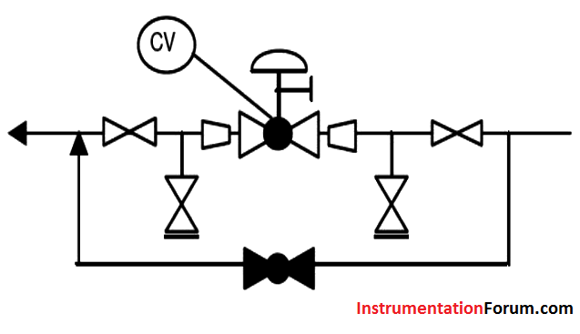

A typical arrangement used to represent control valves on P&ID is depicted below.
Control Valves in Process Drawings

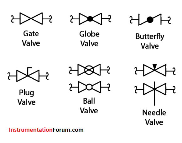

The figure below shows a list of typical valve symbols used in industry.
Control Valves P&ID Symbols

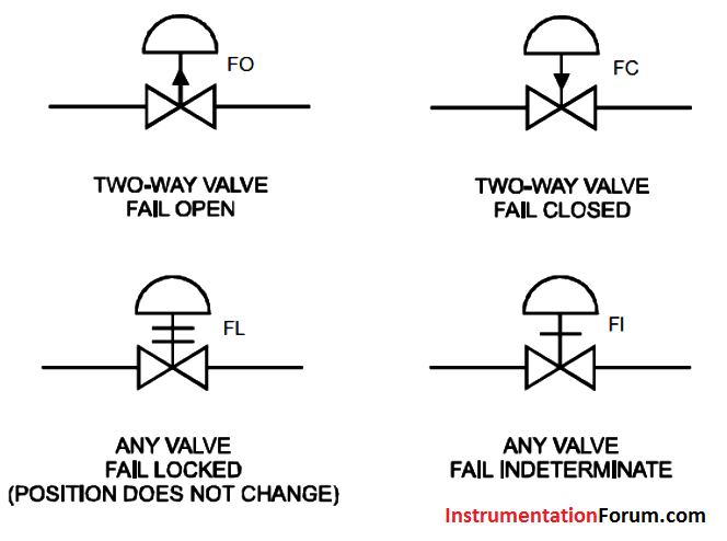

Control valves may fail in various positions: open, closed, locked, or indeterminate, and it needs to be shown on the P&ID.
The fail positions may be identified using letters below the valve symbol: FO for Fail Open; FC for Fail Closed; FL for Fail Last or Locked; and FI for Fail Indeterminate.
The fail positions may also be identified by an arrow. An arrow up signifies the valve fail open and an arrow down is fail close. A crossing line is fail indeterminate.
Two crossing lines indicate fail locked or last position.
