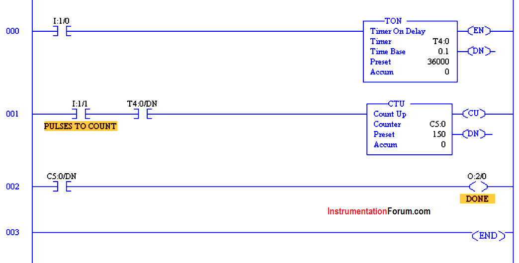

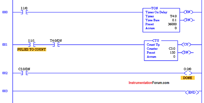

A process where a count of events is to start after a fixed time interval using ladder logic.
Delayed Start of the Counting Process
In this process we do not wish to start counting until one hour after the process starts.
A timer output contact in the timer run line closes after the time period.
The closure then enables the counter to start counting input pulses.
After a count of 150, the output comes on.
