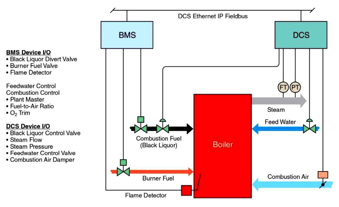

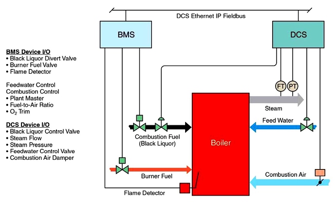

As a more complex example, a paper mill has a recovery boiler system to support the paper making process and supply steam to turbines used to generate electricity, sending the exhaust to heat paper drying rollers.
The boiler has two main functional systems: combustion control to determine how much steam it’s putting out, plus a burner management system (BMS) to ensure it is running properly with a stable flame and no residual unburned fuel. In this case, the primary fuel is black liquor supported by fuel oil or gas.
Since steam output is a process variable based on the needs of the paper machine and the amount of power the generators are producing, it is controlled by the DCS. It tells the boiler how much steam to put out, and it does it by controlling fuel flow (black liquor) and combustion air for the necessary amount of fired heat, along with feedwater to keep up with steam output.
The BMS, on the other hand, is a more discrete function. It turns the fuel on and off. If there is a problem, it shuts down. It needs to be able to execute such a shutdown even if the DCS is calling for steam. The BMS is governed by a variety of safety regulations, including National Fire Protection Association (NFPA) regulations, which define how it has to function.

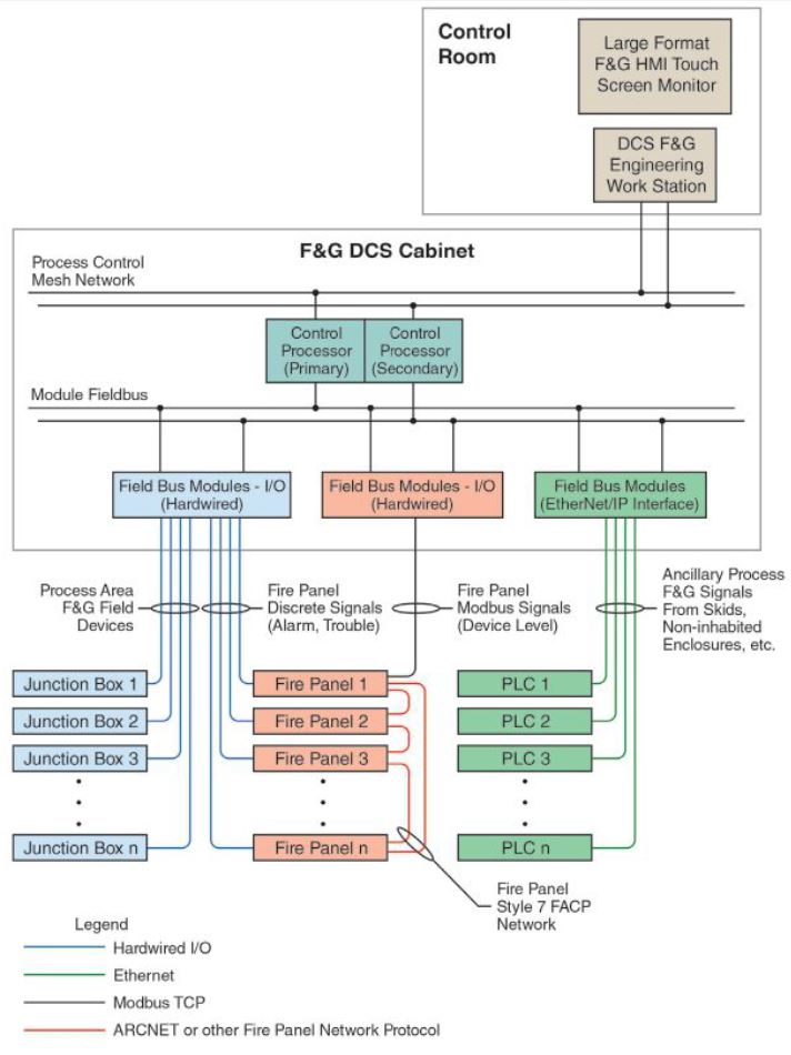

All of the subsystems have to be tied together so operators can monitor and control all the elements from one place. Even if a chemical injection skid is fully capable of working on its own, operators will want to be able to turn it on and off and know what its settings are without having to hike out to wherever it is. Nothing exists in total isolation.
The nature of the inter-system connections depends on the functionality and speed. If there is a strong safety element, the subsystem will probably be hardwired, I/O to I/O.
Something less critical can communicate via Modbus or some other serial network, or increasingly, via an Ethernet protocol. Direct serial links are being replaced by more conventional Ethernet networking strategies as IT practices move onto the plant floor.
Larger networks are particularly useful where a subsystem has to connect to multiple DCS platforms, such as where a plant utility might have to serve more than one process unit. The subsystem has to be sophisticated enough to balance those demands and adjust itself accordingly.

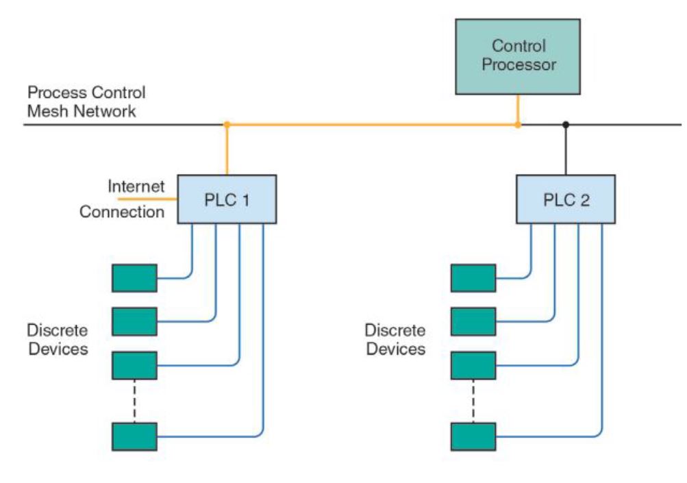

As networks grow in size and complexity, the attack surface for intrusions by criminals also grows. Adding a pump skid with its own small control system does not have to create another entry point, but it certainly can do so, often with good reason.
Say the pump skid builder realizes it may be necessary to access the skid at some future point to gather diagnostic information or troubleshoot a problem.
The engineer adds a cellular modem or a Wi-Fi router to the control cabinet so the technician can access the device. This connectivity was not specified by the customer— the builder did it for its own convenience. If a hacker can access this device, it can serve as an entry to the larger system. The customer needs to be very specific as to what communication capabilities are permissible and which are definitely not.
When multiple systems are connected by a network, appropriate isolation and segmentation should be observed. For example, say someone within the company decides it is important to monitor the performance of a skidded subsystem for whatever reason. The individual might ask for access to the desired data via the DCS.
