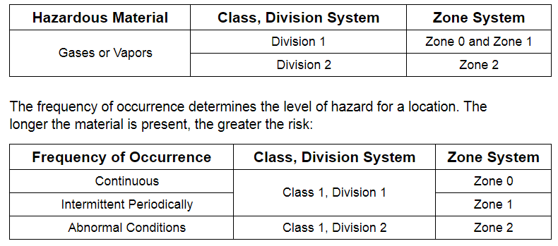

The NFPA establishes area classifications based on Classes, Divisions and Zones that when combined delineate the hazardous conditions of a specific area.
This classification method provides a description of the hazardous material that may be present, and the probability that it is present, so that the appropriate equipment may be selected and safe installation practices followed.

The table below provides a comparison between the “Class, Division” System and the “Zone” System:
