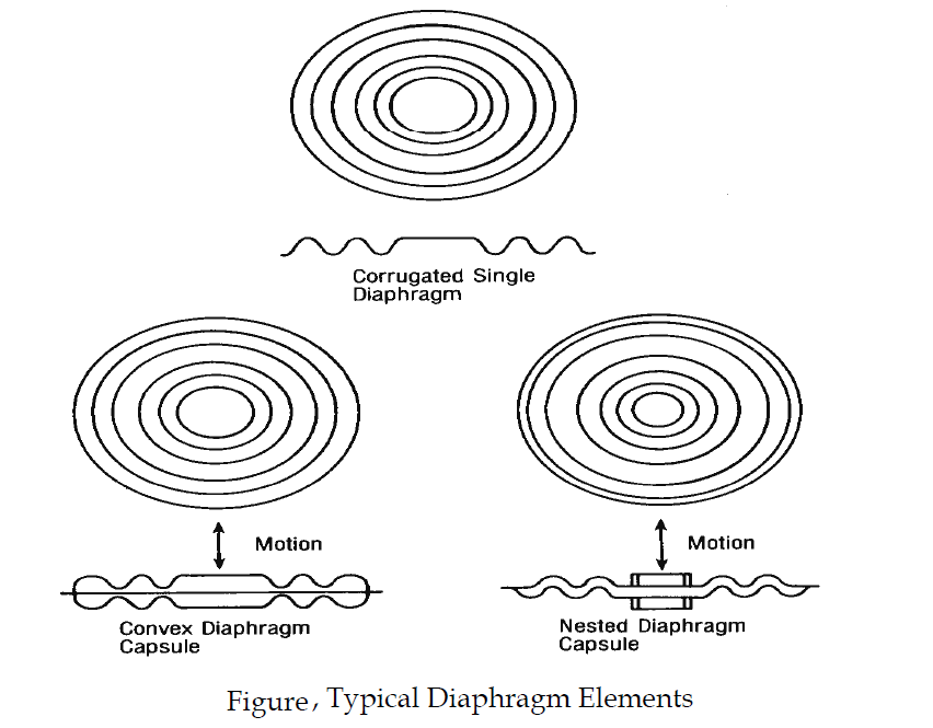

There are two types of diaphragm elements, elastic and limp. The elastic type uses the stiffness of the diaphragm to oppose the pressure applied. It is usually metallic and comes in two different configurations; single and capsular. The single diaphragm is, as its name implies, a single diaphragm either flat or with concentric corrugations.
The capsular diaphragm consists of two diaphragms welded together at their perimeters as shown in figure.

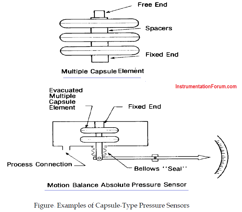

Capsules can be either convex or nested as illustrated. Capsules can be mounted in multiples to give more deflection for a given pressure as shown by below figure. Evacuated capsules are used for absolute pressure reference and single diaphragms for very sensitive measurements.
