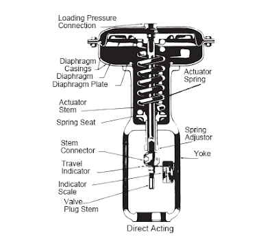

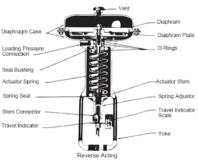

The following clarified the different features between direct and reverse acting valve.
Direct acting valve
Air to close – Spring to open — Failed Open (FO)
(increasing air pressure pushes down diaphragm and extends actuator stem)
Reverse acting valve
Air to open – Spring to close — Failed Close (FC)
(increasing air pressure pushes up diaphragm and retracts actuator stem)
