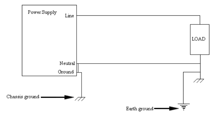

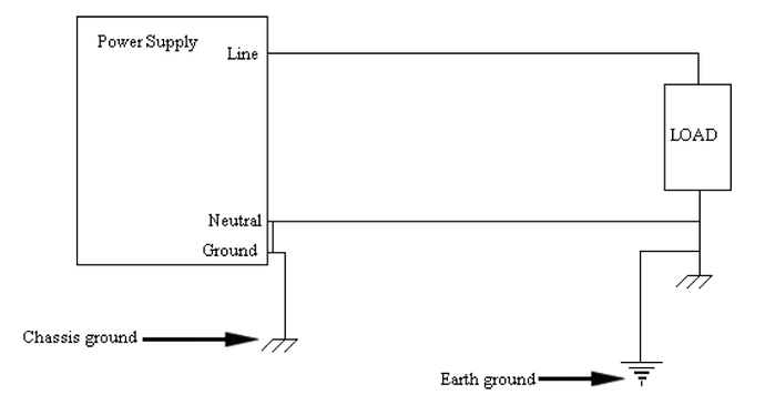

Thus the term “earth ground”denotes a connection to an actual earth reference point (see Figure).
Earth Ground and Chassis Ground
Figure: The “ground” point on the power supply is a chassis ground while the load has an earth ground reference.
The term “chassis ground” (Figure) indicates a ground reference on the dead metal enclosure points of an electronic device.
It is possible for this ground reference to sit at earth potential or at some other value if it is not grounded to earth. In the case where the chassis is not earth grounded, it is said to be “floating” at some potential other than earth ground.
