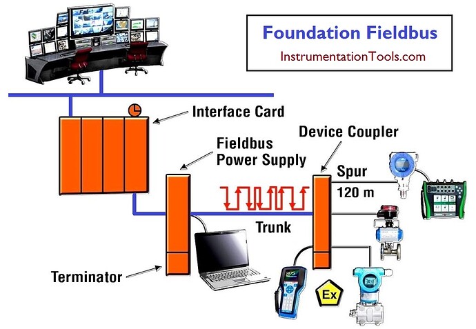

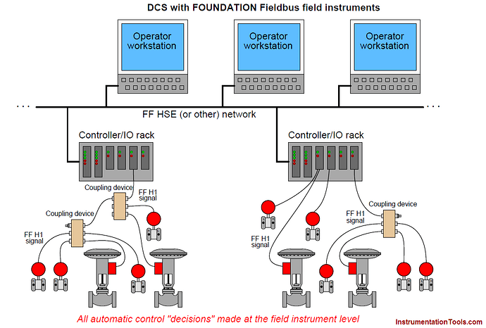

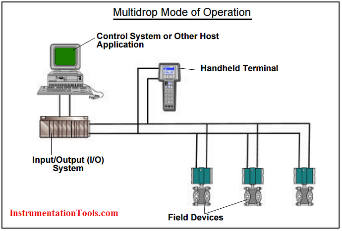

What are the main Difference between HART Protocol and Foundation Fieldbus used in industrial measurement devices.

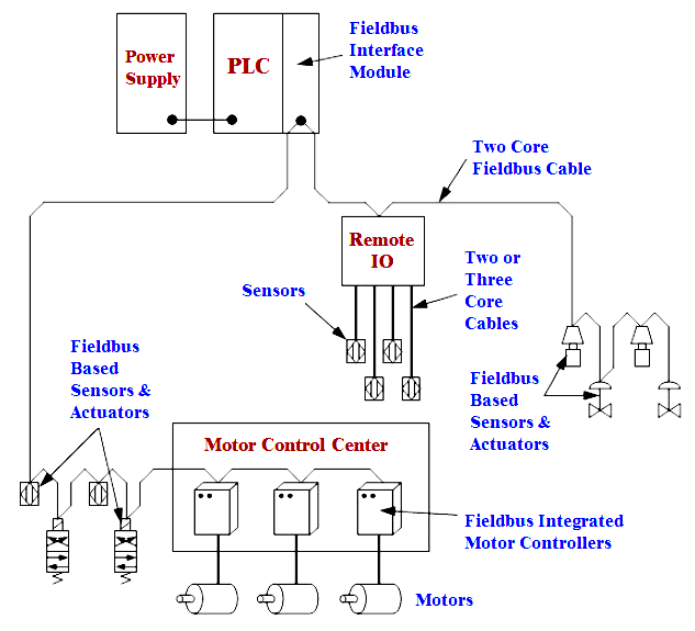

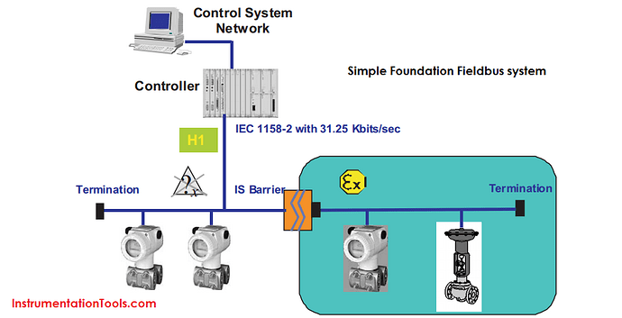

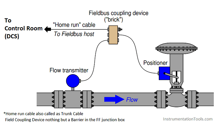

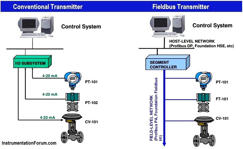

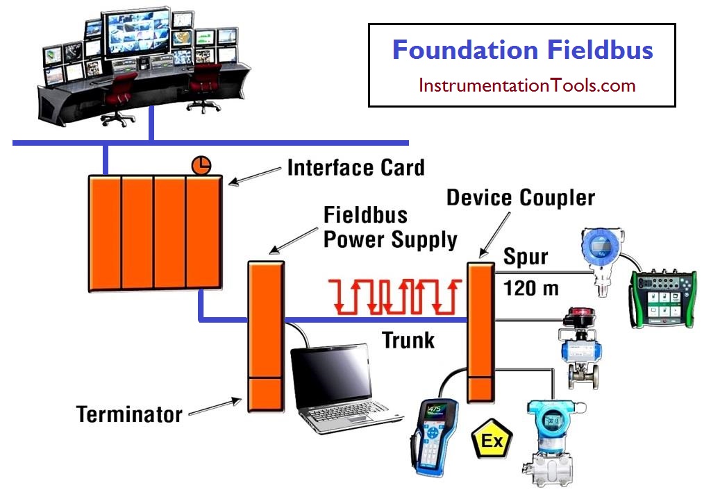

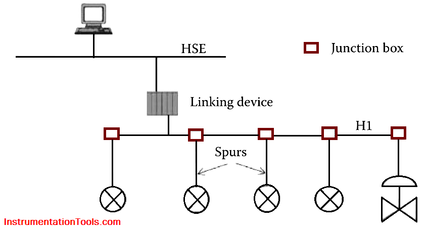

The main advantages of fieldbus protocol over HART protocol is as follows.
- Real-time closed loop control completely digital end-to-end, from sensor to actuator
- More current for more powerful two-wire loop powered devices like radar level transmitters, multi-channel temperature transmitters, and more diagnostics etc.
- Balanced (non-grounded) signal with high amplitude for noise immunity
- Intelligent discrete devices like two-wire on/off valves
- Multiple devices on the same pair of wires reducing cable, tray, junction boxes and associated labor
- Multiple signals (per device) on the same pair of wires dramatically reducing cable, tray, junction boxes and associated labor
- Dramatic reduction of I/O cards reducing system footprint and weight
- Elimination of I/O card selection simplifying engineering
- Elimination of safety barrier selection simplifying engineering
- Elimination of signal marshalling simplifying engineering
- Easy addition of devices
- Easy addition of signals in devices
- Easy to change design to other device type: e.g. on/off valve to control valve or MOV
- Time synchronized control
- Fast control response period

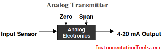

- No 4-20 mA range mismatch
- No 4-20 mA current calibration skew
- Signal distortion detected
- Measurement over full sensor limit (no 4-20 mA range)
- No 4-20 mA five point loop test
- Real-time PV validity indication
- Position feedback on every valve
- Multi-channel temperature transmitters
- Advanced device diagnostics
- Centralized firmware upgrade
