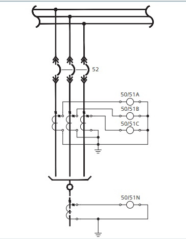

- Direct Ground Current Measuring:
CBCT is used for earth leakage and sensitive Earth Fault conditions. CBCT encircles the three-phase conductors and measures zero sequence (ground) current directly. This is used as an input by the Relay to measure Earth Fault current.
This method is well suited for use on low resistance grounded systems, but not well suited for use on solidly grounded systems

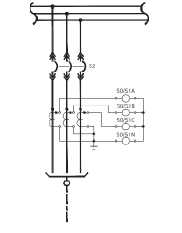

- Residual Ground Current Measuring:
Measuring of ground current by means of an overcurrent relay located in the common return conductor of the CT secondary current.
This method is appropriate for solidly grounded power systems, but not well suited for low-resistance grounded systems.
