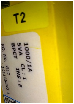

Measurement C.Ts:
- These are noticed by their yellow color in the circuit.
- The limits are well defined.
- These require good accuracy up to approximately 120% rated current.
- Require low saturation level to protect instruments, thus use nickel iron alloy core with low exciting current and knee point at low flux density.
- Metering C.Ts are classified into various classes based on the highest permissible percentage ratio error at rated current.
- The classes are defined as class 0.1, class 0.2,class 0.5,class 1, class 3, class 5.
Metering C.T

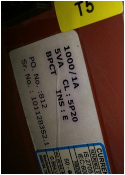

Protection C.Ts:
- These are noticed by their brown color in the circuit.
- Operation over wide range of currents.
- Accuracy not as important as measuring CTs.
- Require accuracy up to many times rated current, thus use grain oriented silicon steel with high saturation flux density.
- Protection C.Ts are classified into various classes
- The classes are defined as 5P20, 10P20…
Here 5P20 means
5->%Error
P-> Protection Class
20-> 20 times of rated current
Means when 20 times of rated current is flowing through CT the error in secondary current may be ± 5%.
Protection C.T
