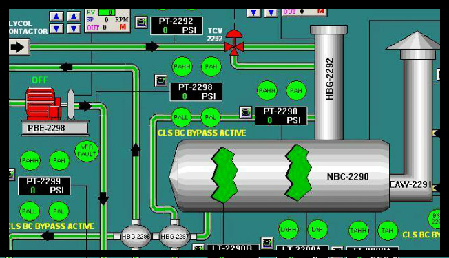

HMI
HMI = Human Machine Interface - A few examples are: a DCS graphic, a keypad connected to a VFD (Variable Frequency Drive), a keypad connected to a PLC, a graphical representation of a process that utilizes a mouse and/or touch screen to allow an operator to interact with an industrial automation system (of any kind).
Basically, anything that a human interacts with the manipulate, monitor, and edit a control system.
