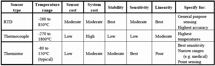

Thermocouples are inexpensive, rugged, and have a fast response time but are less accurate and the least stable and sensitive. Thermocouples also read only relative temperature difference between the tip and the leads while RTD’s and Thermistors read absolute temperature. RTD’s are the best choice for repeatability, and are the most stable and accurate. However they have a slow response time and because they require a current source they do have a low amount of self heating. Thermistors have a fast output and are relatively inexpensive but are fragile and have a limited range. They also require a current source and do experience more self heating than an RTD and are nonlinear.
