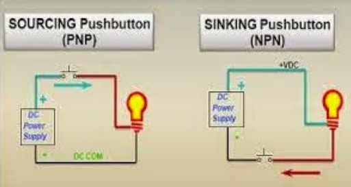

Look at this issue in simple terms. A basic circuit to show as an example is the circuit used to turn on a light. Why is there a light switch in a kitchen? Obviously so the light turns on and off…
A switch is used to control the power going to the light so it is not on all the time. If a switch was not needed, you would simply place 120 VAC to one side of the light and attach the other side to neutral (or ground) to complete the circuit.
A switch between either the line power (120 VAC) and the light or ground and the light controls the circuit, enabling it to turn on and off. If the switch is between the power and the light, voltage is sourced to the light, completing the circuit.
The light is always attached to the neutral (ground) line, so when the switch turns on, power is supplied (Sourced) to the light, turning it on. If the switch is between neutral (ground) and the light, the light sinks to neutral (ground), completing the circuit.
The light in this case is always attached to the power line, so when the switch is turned on, the neutral (ground) is connected (sinked) to the light, turning it on.

Before PLCs, switch outputs would typically turn a control relay on or off to control the next phase of the process. If the switch attaches between the power supply and the control relay, the circuit is a sourcing circuit.
If the switch attaches between the control relay and ground, the circuit is a sinking circuit. The decision regarding which circuit to use may have been made for safety concerns (to reduce chance of electrical shock). Or perhaps a standard was adopted at a factory specifying that all circuits would be wired the same way, whether it be sinking or sourcing.

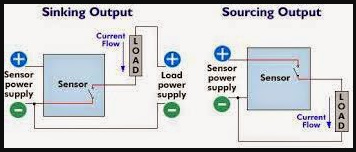

Difference between source and sink
Sinking and sourcing are terms used to describe how an associated load (the device being turned on or off by the sensor) is powered in relation to the sensor.
Sinking, the more widely used of the two, involves the switching of load current (power) supplied by a power source external to the sensor. In a sinking configuration, current passes through the load first, through the output switch of the sensor second and lastly to ground.
A sensor with a sinking output switches the ground, or negative, leg of the circuit. In contrast, sourcing refers to a configuration in which the sensor is the source of the current required to power the load.
In a sourcing situation, current supplied by the sensor passes through the load second and then to ground. A sensor with a sourcing output switches the positive leg of the circuit.
