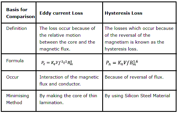

- The loss which occurs because of the eddy current is known as the eddy current loss. The eddy current induces because of the interaction of the variable magnetic field and conductor. The loss which occurs because of the reversal of the magnetising force is known as the hysteresis loss.
- The eddy current loss occurs because of the interaction of magnetic field and conductor. The hysteresis loss occurs because of the reversal of the magnetism.
- The eddy current loss is minimised by using the thin core of lamination. The silicon steel material is used for minimising the hysteresis loss.
