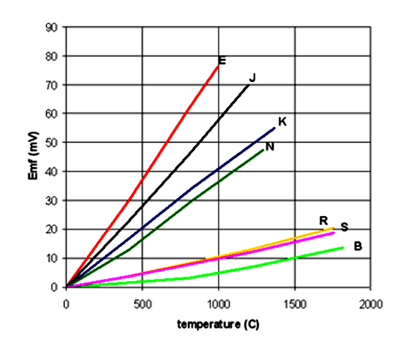

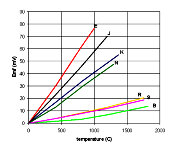

The graph below shows the thermocouple characteristics and relationship of temperature vs. mV output for all main base metal and nobel thermocouple types. This shows that Thermocouple Sensors have a relatively linear output.
