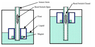

1. Level Detection and Measurement by Using a Float Sensor
Level Detection Using a Float Sensor
Principle of Operation:
A liquid level control system by using a float sensor works on the principle of buoyancy, which states, “A float immersed in a liquid is buoyed towards upward direction by an applied equal force to the weight of the displaced liquid”.
As a result, the body drives partially and gets submerged upon the liquid surface and covers the same distance the liquid level moves.
Construction:
A level measurement float system consists of a float, a sensor stem, a magnet, a reed switch and a weight suspended on the outside of the open tank.
A scale is fixed on the outside of the tank, and the contents of the tank’s level are indicated by the position of the weight along the scale.
Working: Level detection of liquids is often done with a float-type liquid level switch. The float transfers on a mechanical arm or sliding pole and activates a switch when the level moves towards upward direction.
Sometimes the float itself contains a small magnet that varies the state of a switch when the liquid level gets moving up and moves into the original position. This type of level sensor comes with many advantages like it is very simple, highly accurate, and best suitable for various products.
The Disadvantages of this sensor are that it requires various mechanical equipment, especially the pressure vessels.
Primary Areas of Float Sensor Application: In view of the requirements pertaining to the increase in usage of sealed tanks, the current industrial systems make use of this type of float method for precise reading and accuracy, which is a good example of electronics and mechanical engineering, making it the most accurate level-measuring system for various applications in very large storage tanks.

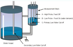

3. Level Detection by Using Conductivity Probes
Principle of operation:
The principle used in this system states that “the presence of a product will make a change in the resistance between the two conductors.”
Construction and Working
This system is applicable for level measurement in conductive liquids. The conductivity of the insulated material can be varied if the probe is covered or not covered within the conductive product. There are two electrodes: one is used as a metal wall of the tank, and the other electrode is inserted into the tank. This principle can be explained with a practical application.
A Conductive probe is used as a liquid level indicator for measuring the level of electrically conductive products in a metal water tank, or other container, which can be obtained by means of a probe isolated from the container and a conductivity amplifier.
When the product is not in connection with the probe, the electrical resistance is relatively high or infinite between the probe and the metal tank wall. If the level of the liquid rises completely between the probe and the tank wall, then the resistance gradually decreases.
This method is Advantageous as it is very simple, low cost and well suited for dual or multiple point control.
The method is disadvantageous as the probe must not get contaminated with grease or any other deposits and has limited suitability for products of varying conductivity.

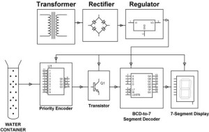

As a practical example of this detection here we have shown figure of intelligent overhead tank water level indicator with block diagram which uses conducting probes for detecting the water in tank. This system is built by using priority encoder, BCD-seven segment decoder, seven segment display and other miscellaneous components.
Intelligent Overhead Tank Water Level Indicator
The probes are connected to +5V and the return or ground terminal is kept at the bottom of the tank. Nine active-low inputs of priority encoder are converted to active- low BCD output by internal circuitry and then the water level is indicated in seven segment display interms of percentage of water.
As the water level is increases probes get shorted and correspondingly priority encoder gives BCD values and later the information is displayed on seven segment display through BCD to seven segment decoder IC.

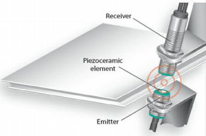

1. Level Detection and Measurement by Using Ultrasonic Sensor
Level Detection Using Ultrasonic Sensor
Ultrasonic level instruments works on the basic time-of-flight principle which states that sending a sound wave from a peizo electric transducer to the contents of the vessel, which may contain liquid, solid or slurries level.
This liquid level sensor comprises two elements such as an associated electronic transceiver and a transducer with relatively high efficiency. In case of a liquid level controller, the fluid level can be determined by measuring the trip time difference between a transmitted ultrasonic pulse and a reflected echo.
The frequency range for ultrasonic methods varies from a range of 15-200 kHz for transmitting and receiving ultrasonic waves. The lower frequency instruments are used for the measurement of difficult applications such as longer distances and solid-level measurements, and the instruments with higher frequency are used for shorter liquid level measurements.
The ultrasonic sensors are advantageous as they are not in direct contact with the product, and the level measurement is done without involving any physical contact. They do not have any moving parts.
As a disadvantage, these types of sensors are not suitable for higher pressures in a vacuum and temperature limits of up to 170 degree centigrade.

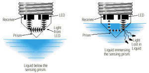

3. Level Detection and Measurement by Using Optical Sensors
Level Detection Using Optical Sensors
The optical sensor consists of an infrared LED and a light receiver. The light emitted from the LED is directed towards a prism which forms the tip of the level sensor. If there is no liquid present in the tank, then the light from the LED is reflected within the prism and the receiver.
When the liquid level raises and immerses the sensing prism, the light gets refracted out into the liquid, leaving little amount of light or no light to reach the receiver. Sensing this change, the receiver activates electronic switching within the level unit for operating external alarm or control circuit.
The advantages of this optical sensor are that they are not in contact with the process, and perform accurate measurements of small level movements.
The disadvantages of these sensors include limited applicability and sometimes a high-cost of installation.
