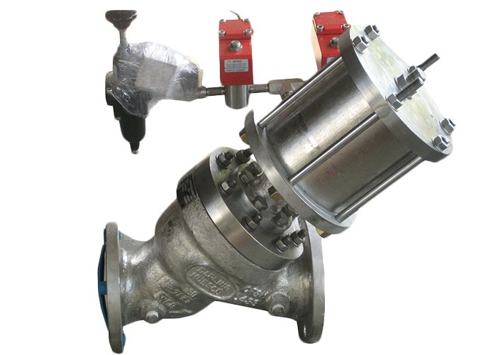

The DCV operates based on pneumatic actuation provided with a pressure range from 5-7 Kg/cm2. The DCV can be controlled by means of electronic components for example; BCU (Batch Controller Unit).
BCU provides a range of operation where the DCV can ramp up/down based on flow input in parameters as per operational requirement. For a 4" line it can control flow ranging from 60 kg/min to 1200 kg/min.
The BCU commands NO/NC SOVs for ramping up/down the flow. The SOVs posses plunger which can control pneumatic air in & out the DCVs piston and shaft. The air regulator is attached along with the pneumatic line to avoid pressure surges.
The DCV automatically reduces a higher inlet pressure to a constant lower outlet pressure. The valve consists of a main valve and pressure reducing control pilot. Slight changes in downstream pressure acts on topside of control diaphragm causing main Valve to counteract pressure changes and hold a constant outlet pressure.
The regulator will reduce the upstream pressure to a constant downstream pressure regardless of the change in flow rates/or inlet pressure.
Digital Control Valve
*Size: 50 NB to 150 NB
*Pressure Range: Up to 17.5 Kg/cm2
