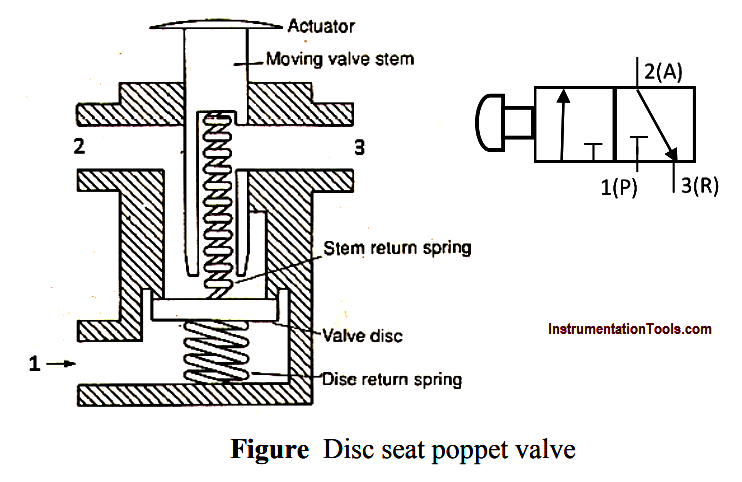

Figure shows the construction of a disc type 3/2 way DCV. When push button is released, ports 1 and 3 are connected via hollow pushbutton stem.
If the push button is pressed, port 3 is first blocked by the moving valve stem and then valve disc is pushed down so as to open the valve thus connecting port 1 and 3. When the push button is released, spring and air pressure from port 1 closes the valve.
