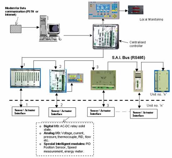

In the mid-1970s, microprocessor-based modules replaced hardwired computer modules. The typical DCS had the configuration shown in Figure1. Today’s distributed control systems are much more powerful and
faster than the first systems because of improvements in microprocessors and other electronic circuits.
Fig. 1: Typical DCS configuration.

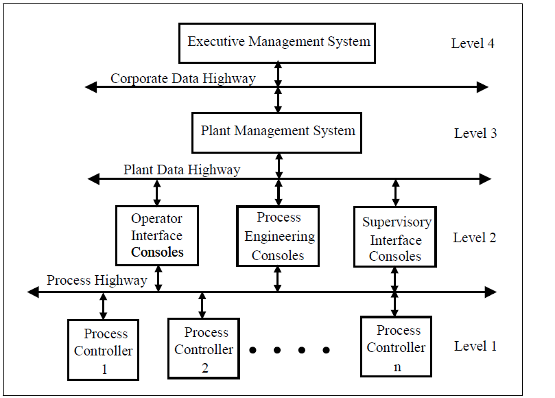

Distributed control systems today consist of one or more levels of control and information collection, as shown in Figure 2. The lowest level is process control and measurement on the plant floor. At this level, microprocessor- based controllers such as programmable controllers execute loop control, perform logic functions, collect and analyze process data, and communicate with other devices and to other levels in the system.
In Figure 2 , the process data collected at level 1 is transferred to level 2. At this level, process operators and engineers use operator consoles that have a keyboard, mouse, and video display to view and adjust the various processes being controlled and monitored by the system. Also, at level 3, process and control engineers implement advanced control functions and strategies, and members of the operations management team perform advanced data collection and analysis on process information. The various plant management systems—such as inventory management and control, billing and invoicing, and statistical quality control—exist at level 3. The highest level (level 4) is used in large industrial plants to provide corporate management with extensive process and operations information.
Fig. 2: Distributed Control System Level
