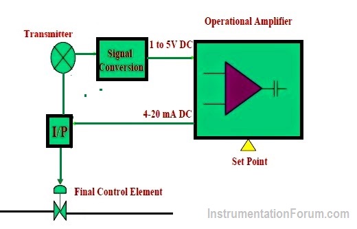

1)ANALOG CONTROL SYSTEM:
In an analog control system,The controller consists of analog devices & circuits i.e. Amplifiers. The signals coming from the process will be analog in nature(i.e. voltage or current signal).
In an analog control system any change in either setpoint or feedback is sensed immediately and the amplifiers adjust their output accordingly.
In the diagram, we can see that transmitter is sending an voltage signal to the operational amplifier & operational amplifier is sending its command to FCE(final control element) in current signal.
Both the signals sending and receiving by the amplifier is analog in nature and there are no signal converters in this control system.

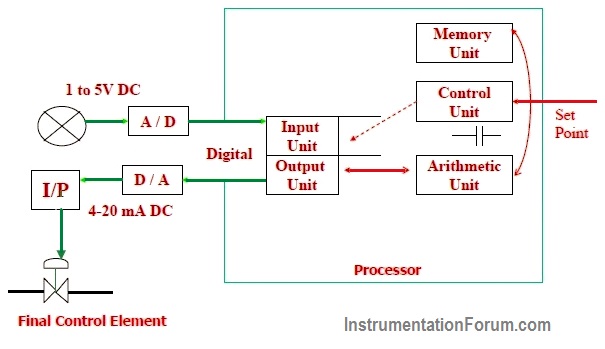

2)DIGITAL CONTROL SYSTEM:
In an digital control system, The controller use microprocessors to do the control function.
Digital control systems are preferred over analog control systems because it is easy to interface with computers for data analysis.
From the above diagrammatical presentation we can understand the working principle of digital control system & we can understand that most control systems are controlling analog control processes.
This means that in many cases the digital control system must be first convert analog input data into digital form before it can be processed and similarly the output from the controller must be converted into the digital form to analog form.

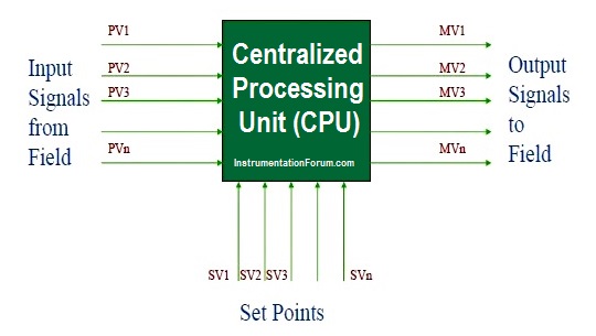

1)CENTRALISED CONTROL SYSTEM
In this type of control system the monitoring functions and control functions are centralised.
In the diagram, we can see that all the inputs from the field and all the set points of different processes are given to a single processor or cpu and all the commands to final control elements are sending through the same cpu.
DISADVANTAGES OF CCS
1)If the CPU fails the entire plant will get affected.
2)Redundancy concept is not available in this type of control system. Redundancy is having two controllers. One would be active and the other would be standby. If the active controller fails, the standby controller takes over.

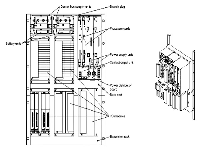

1)CPU:Central Processing Unit also called as Field Control Station
It is used to control the process. All the instruments and interlocks created by software reside in the memory of this unit & all the field instruments like transmitters and control valves are wired to the FCS.
Here we can see that every component(i.e. power supply, processor cards)of the FCS is redundant in nature. One would be active and the other would be standby. If the active one fails the standby takes over the action.
The power supply unit is designed to supply power to the CPU cards, and up to five I/O module nests.
The processor receives information from input modules and sends information to output modules.
The input modules receive information from field instruments in the process and transmit instructions to the output instruments in the field.

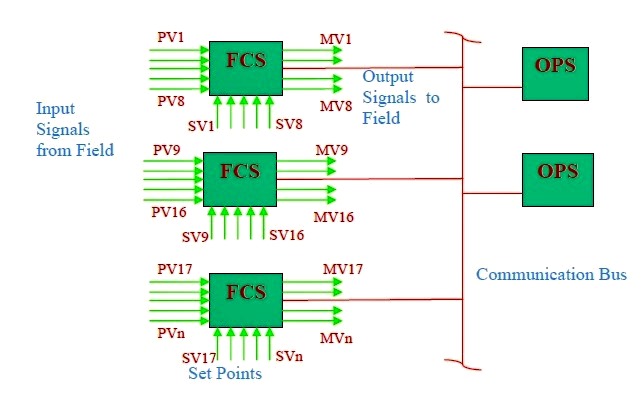

3)Communication Bus:
It is used to communicate between the FCS and the OPS. It plays an very important role in the DCS because, It determines the superiority of the entire control system.
But also the Uploading & Dowloading of the programs and accessing the data & process of the field can be done through Communication bus only.
This, Diagrammatical presentation will give you a clear picture about the role of communication bus in DCS.
