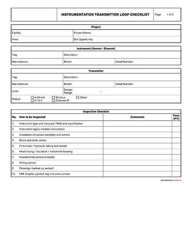

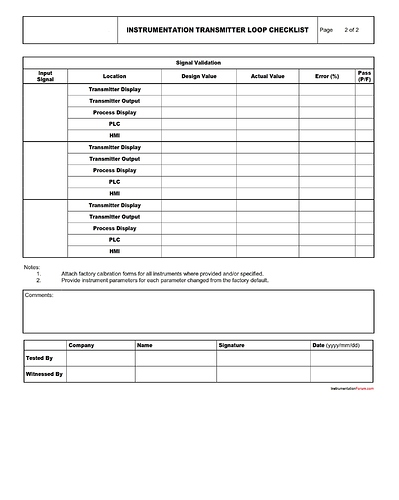

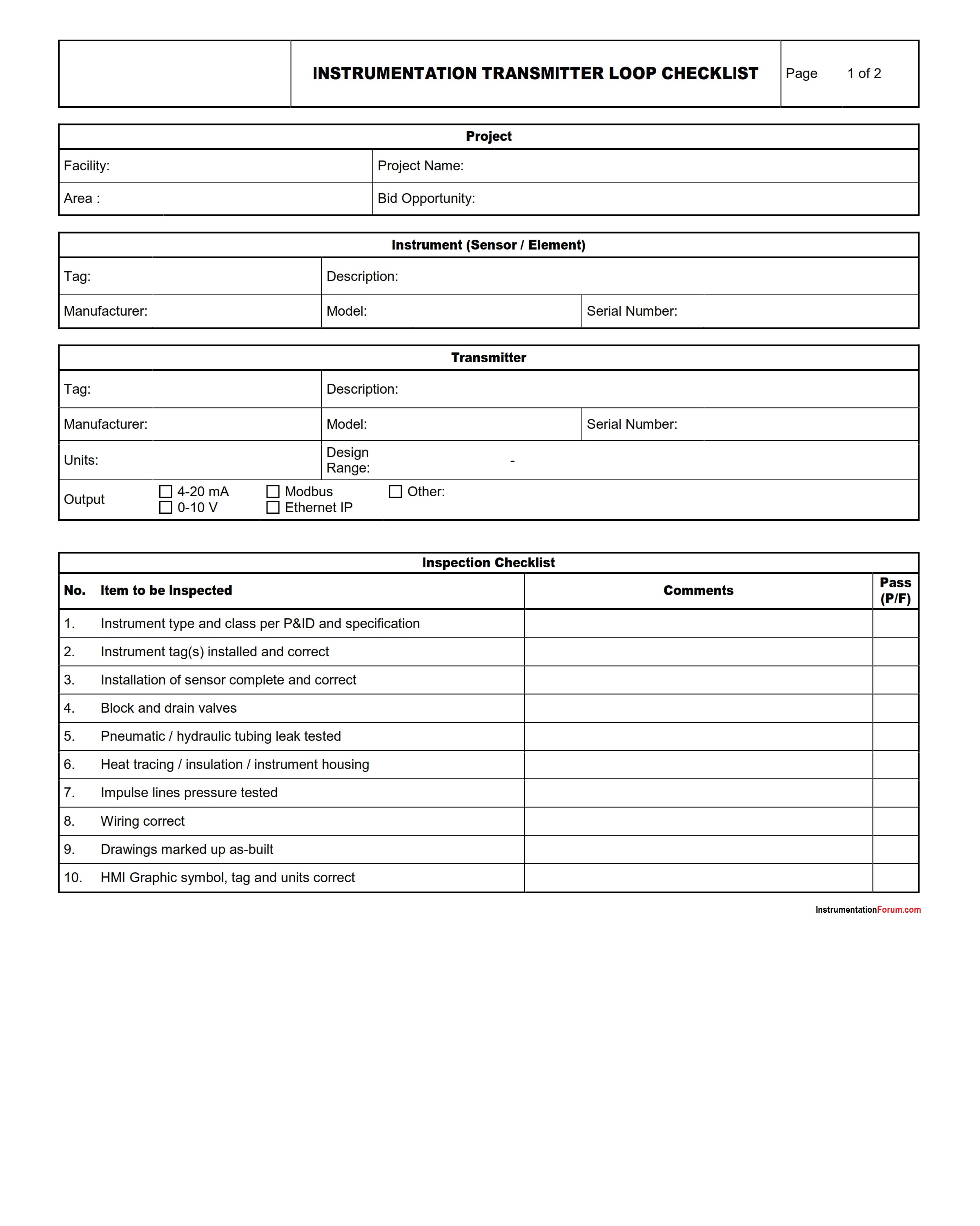

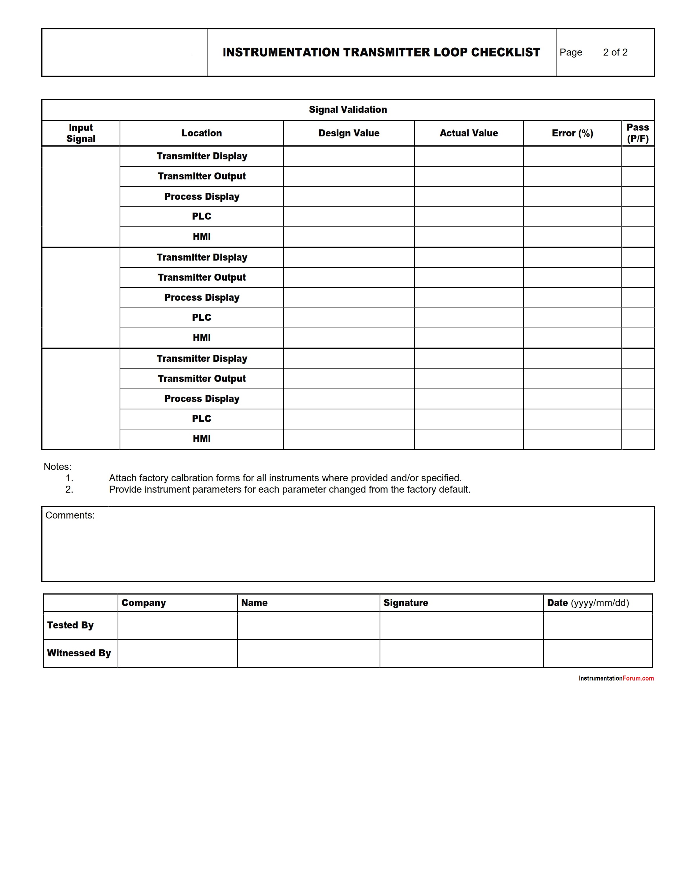

The Instrumentation Transmitter Loop checklist is used to verify the installation of field instruments, configuration, and calibration validation and functional testing.
Inspection Checklist for Transmitter
- Instrument type and class per P&ID and specification
- Instrument tag(s) installed and correct
- Installation of sensor complete and correct
- Block and drain valves
- Pneumatic / hydraulic tubing leak tested
- Heat tracing / insulation / instrument housing
- Impulse lines pressure tested
- Wiring correct
- Drawings marked up as-built
- HMI Graphic symbol, tag and units correct
Download Checklist for Instrumentation Transmitter Loop

- Loop Current: Test the loop current with a multimeter to confirm it’s within the expected range (4-20mA). Check if the loop current changes correctly with variations in the process variable.
- Transmitter Calibration: Check if the transmitter is calibrated correctly. The output current should correspond correctly to the measured process variable. This can be tested using a calibration tool to simulate the process variable and observe the output.
