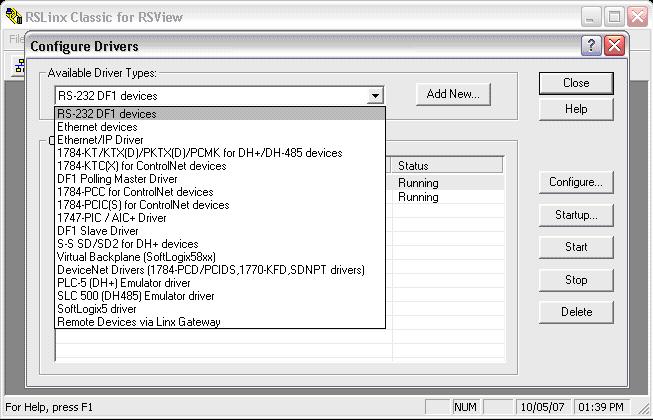

Click on Communications and Configure Driver.
STEP 3 - Add a new communications driver
Click on the drop-down menu and select RS-232 DF1 devices.
Click on Add New.
A window will pop up. Just click OK.
For an Ethernet connection, click on Ethernet/IP Driver .
This will browse the local subnet or remote subnet for PLC devices.

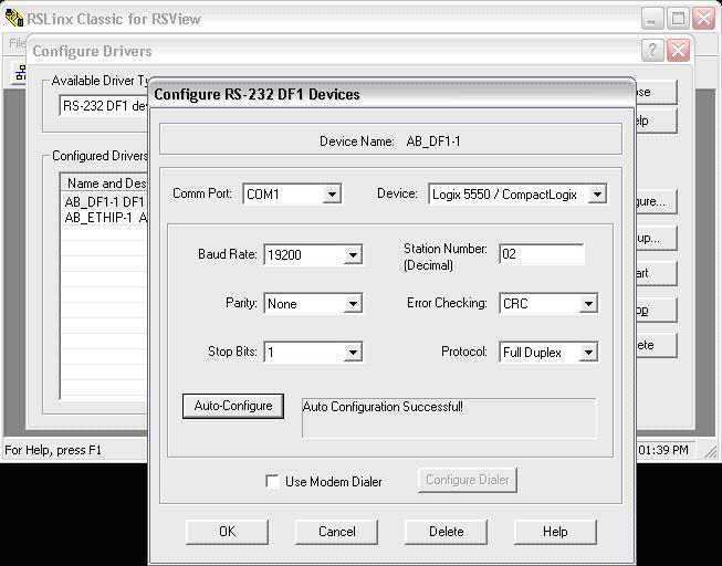

STEP 4 - Configure the communications driver
A window will come up to configure the communication.
Just click on Auto-Configure.

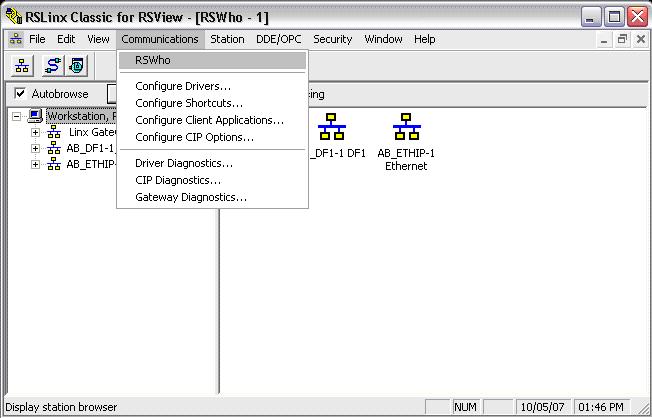

STEP 5 - Display the communication drivers
Click on Communications and RSWho.
This shows the communication drivers you have setup.

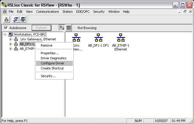

STEP 6 - Reconfigure a communications driver
This step is for users who have setup communications before and need to make a change.
You can right click on the communications driver and click Configure Driver.
This brings up the window from STEP 5 , where you can change the configuration.

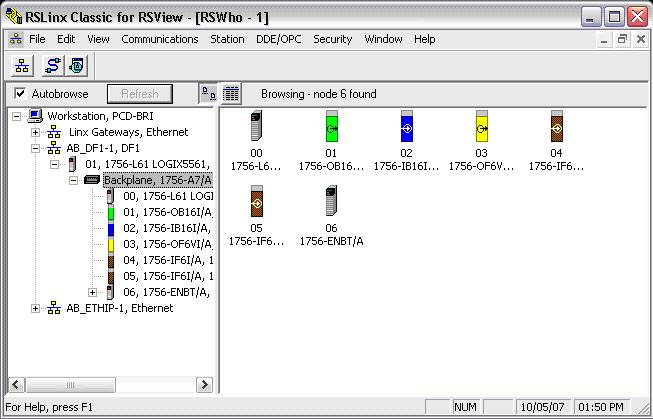

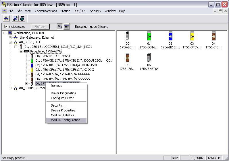

STEP 7 - Display attached devices
If you expand the icons by clicking on the + symbol, you should see your device.
If using Ethernet, you will see all PLC devices in your subnet.

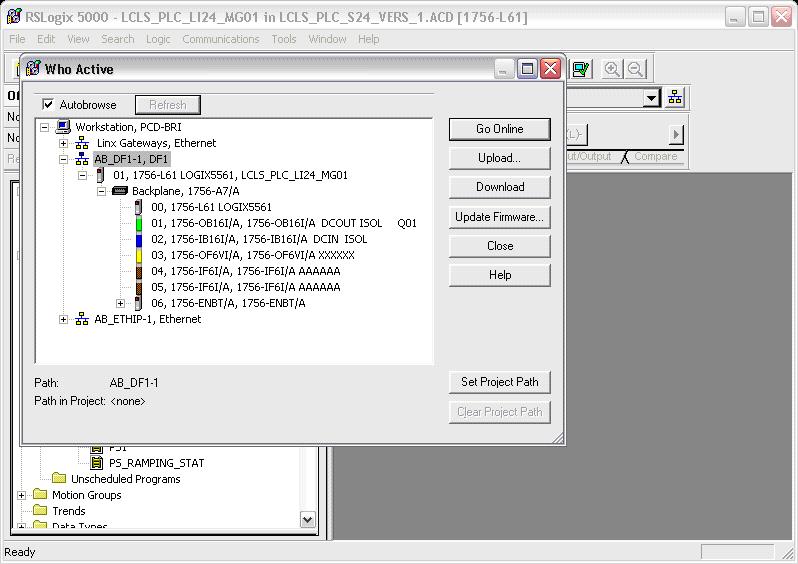

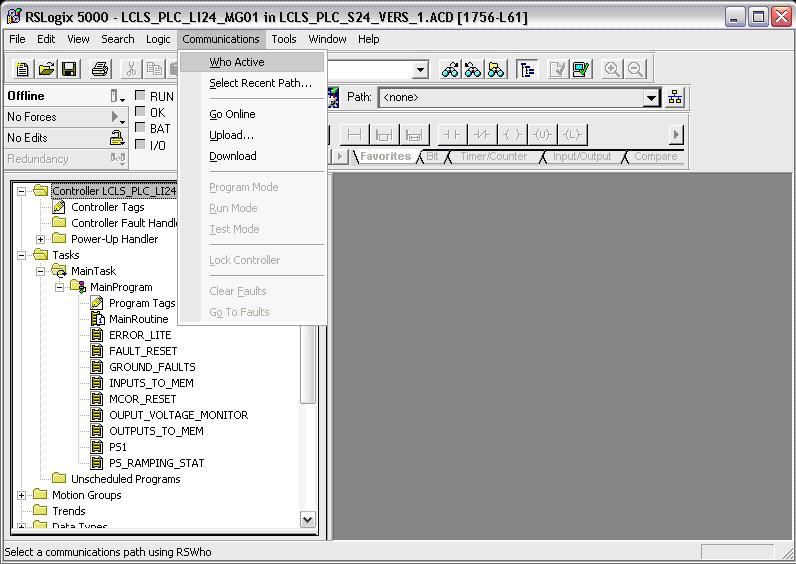

STEP 8 - Open RSLogix5000
Open RSLogix5000 and the applicable file to download.
Click Communications and Who Active.
STEP 9 - Download program
''Warning: This step will take your PLC out of Run mode."
Ensure that the PLC keyswitch in the REM or PROG position.
Click on the + next to your communications driver until you find your PLC.
Click Download and Download again on the new pop up window.

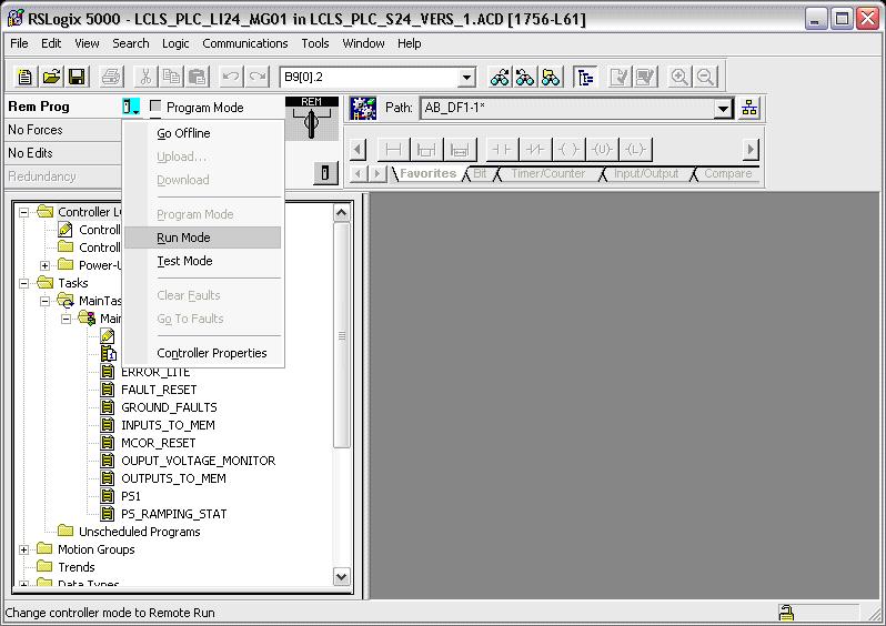

REMOTE RUN: This is done by placing the keyswitch in the REM position and going online to tell the PLC to go into Run mode. In this mode, the PLC can be programmed remotely, whether intentional or unintentional. It is only in this mode that the PLC is able to load the Ladder Logic in nonvolatile memory during power up.
To place the PLC in REMOTE RUN:
Place the PLC keyswitch in the REM position.
Go online with the PLC. Refer to the previous step if you need help.
Click on the small PLC icon and again on Run Mode.

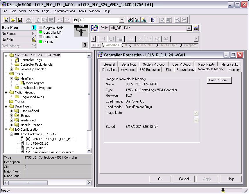

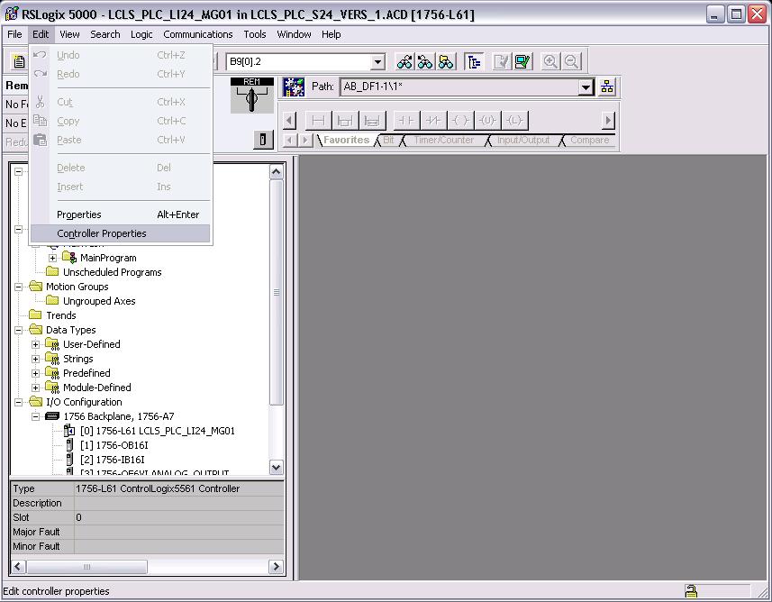

STEP 11 - Open Controller Properties window
When power is down for extended periods of time and the battery dies, the ladder logic loaded in the PLC disappears. Loading an image to nonvolatile memory ensures that the PLC loads the ladder logic from memory during power up.
Start by going online with the PLC and place it in PROG mode. Refer to STEP 9 to see a screen shot of the window with the Go Online option.
Click on the Edit menu and again on Controller Properties
STEP 12 - Display the Nonvolatile Memory properties
A window will pop up displaying the controller properties.
Click on the Nonvolatile Memory tab.
Here you will see the image currently stored in nonvolatile memory.
Click on the Load/Store button.

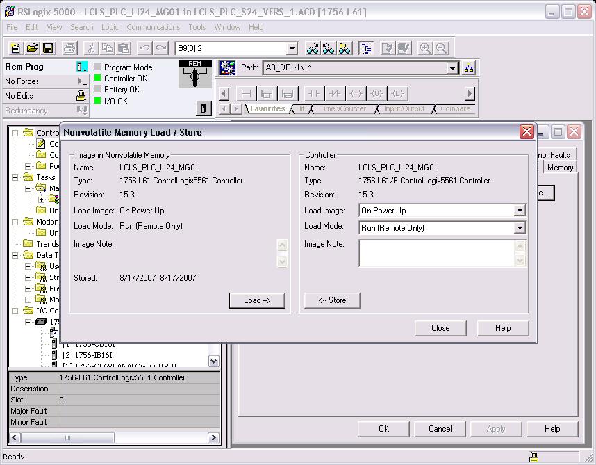

STEP 13 - Store program in nonvolatile memory
A window will pop up with information on the image in memory and options to Load or Store an image.
Select options: Load Image: On Power Up and Load Mode: Run (Remote Only).
Click on <-- Store.
Two windows will pop up. Click on Yes and OK.
