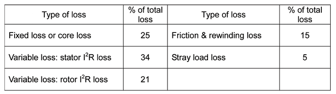

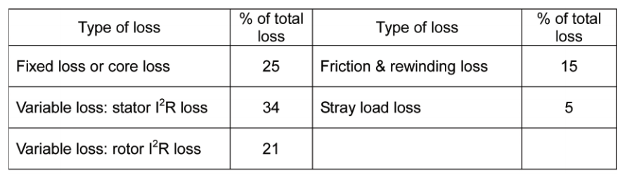

The efficiency of a motor is determined by intrinsic losses that can be reduced only by changes in motor design and operating condition. Losses can vary from approximately 2 to 20 %.
The below table shows the types of losses and their typical shares for an induction motor.
Type of losses and shares for induction motors

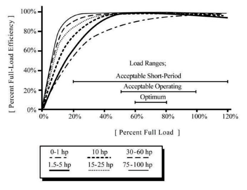

There is a clear link between the motor’s efficiency and the load. Manufacturers design motors to operate at a 50–100% load and to be most efficient at a 75% load.
But, once the load drops below 50% the efficiency decreases rapidly as shown in below Figure overleaf.
Operating motors below 50% of rated loads has a similar, but less significant, impact on the power factor. High motor efficiencies and power factor close to 1 are desirable for efficient operation and for reducing costs down of the entire plant and not just the motor.
