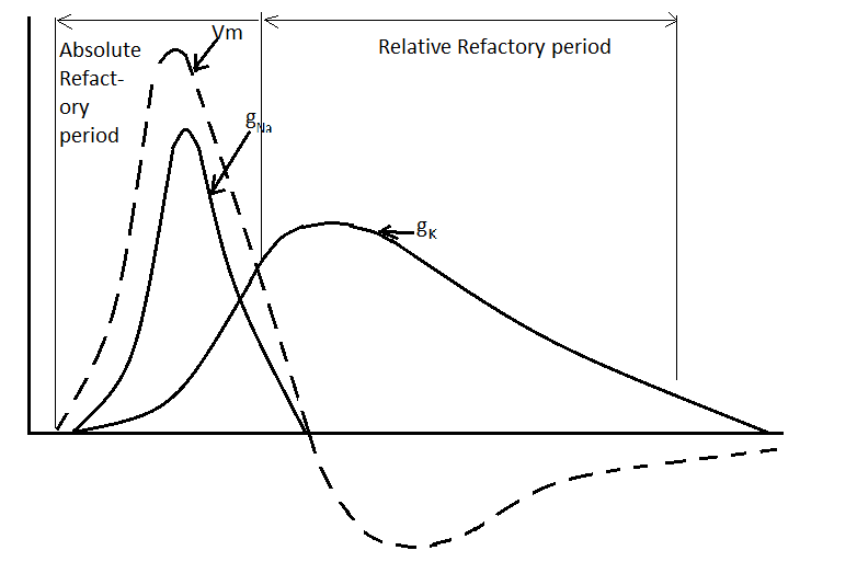

The Active State:
- Another property of excitable cell that brings about depolarization of cell membrane is sufficient to exceed its threshold potential when an adequate stimulus is given.
- When adequate stimulus is given it brings depolarization within cell that must exceed threshold potential.
- At steady state membrane is polarized.
- As cell is depolarised permeability to Na+ increases.
- Na+ rushes into cell, bringing further depolarization.
- Action potential(Vm) tries to reach equillibrium potential of sodium.
- But Vm never reaches to this level because:
(i) Condutance of Na+ is not only voltage dependent but time dependent too.
(ii) There is delayed increase in condutance of K+, that brings hyperpolarizing influence, tending to restore Vm to resting level. - Vm ultimately returns to resting level.
- As K+ continue to leave cell, an undershoot is produced in transmembrane potential(Vm).
