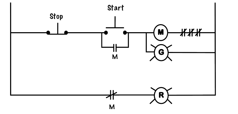

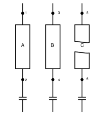

  1. Referring to the drawing, assuming that fuse C is blown, which pair of points will result in a reading of zero volts when the voltmeter is connected across them?

  7. If the circuit in the drawing was operating normally and an overload occurred, then:
A. Both lights would come on
B. The green light would come on, and the red light would go out
C. Both lights would go out
D. The red light would come on, and the green light would go out

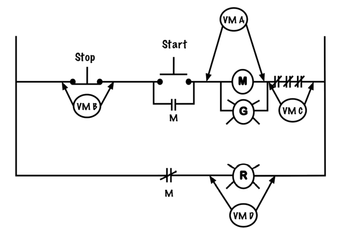

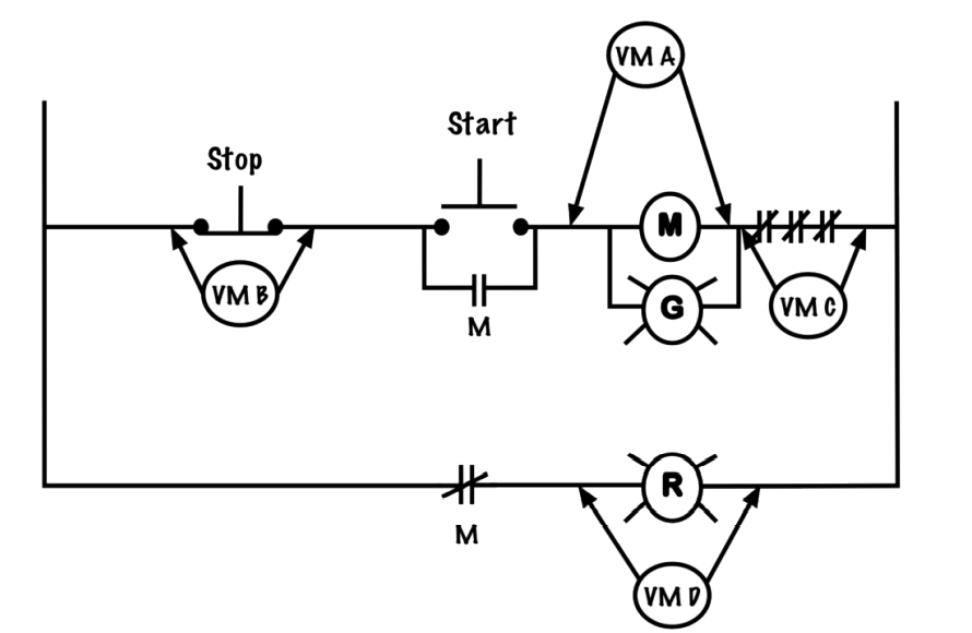

  1. If the control circuit shown below tripped due to overload, then which of the voltmeter
    positions shown would indicate line voltage?
  1. VM A
  2. VM B
  3. VM C
  4. VM D

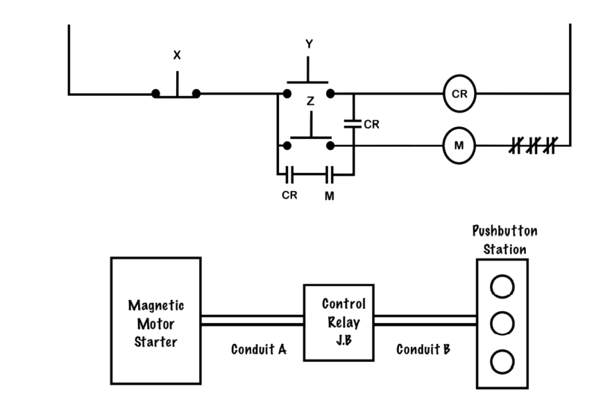

  5. What is the minimum number of control circuit conductors required in Conduit A?
A. 2 wires
B. 3 wires
C. 4 wires
D. 5 wires

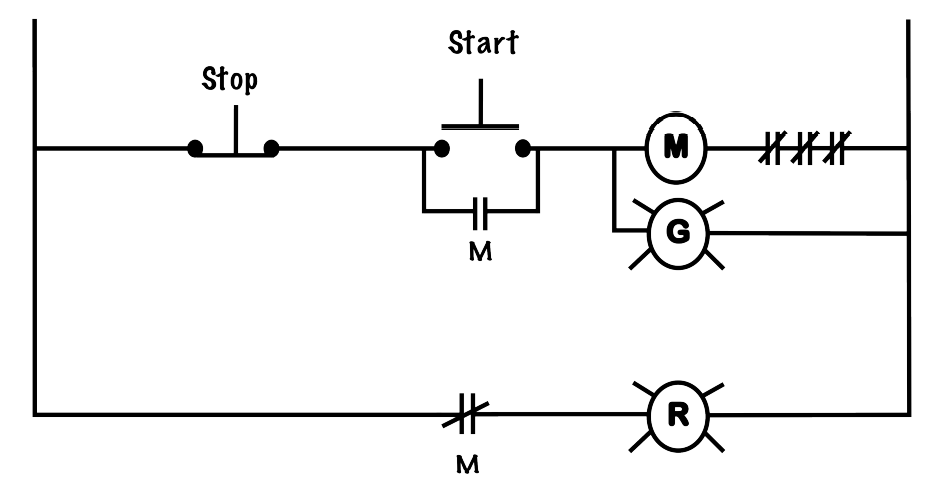

  1. An isolating switch can be used as a motor power circuit disconnect switch. True or false? Use the following image to answer questions 11 and 12.
  1. If the motor starter in the drawing is energized and functioning properly, what should the voltage be across the normally open contact (M)?
A. Line voltage
B. Zero voltage
C. Half of line voltage
D. Twice line voltage
  1. If the motor starter in the drawing is energized and functioning properly, what should be the voltage across the N.C contact (M)?
A. Line voltage
B. Zero voltage
