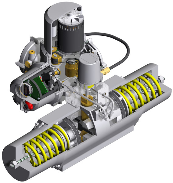

A specialised electric actuator design is necessary to achieve the swift failsafe operation demanded by the Remote Operated Shut-off Valve (ROSoV) duty. Experience has shown that this can be successfully delivered through the electro-hydraulic route.
Electro-hydraulic actuators use a simple and therefore very reliable mechanical spring to provide failsafe valve movement, whilst precise and swift valve movement in the opposite direction is achieved hydraulically by means of an integral electrically powered pump.
With this design, reliable failsafe performance can be combined with the benefits of the latest electric actuation technologies, facilitating a high level of asset management encompassing accurate control, monitoring and alarm signalling, operational data logging and diagnostics.
In Rotork’s case, the Skilmatic range of self contained electro-hydraulic actuators are well established as a solution for electric modulating and failsafe control for quarter-turn or linear valves and dampers. Designed in double-acting or spring return configurations, these actuators comprise of an integrated control module and a power unit consisting of an electric motor, hydraulic pump and reservoir.

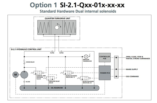

Skilmatic EH actuators operate on a pump and bleed principle utilising a motorised vane pump to provide hydraulic pressure in one direction and spring-return in the opposite (bleed) direction.
When the actuator is commanded to open from the closed limit, the bleed solenoid valves are energised. The motorised vane pump is started under no-load condition as a result of the delay in energising the by-pass solenoid valve. With the by-pass solenoid energised, the system pressure acts against a spring opposed piston to drive the actuator in the open direction.
When the actuator is commanded to stop or reaches the open limit, the by-pass solenoid valve is de-energised, followed by the motorised vane pump after 5 seconds, unless a new command to open is given. The bleed solenoid valves remain energised and the system pressure is maintained to hold the actuator position.
When the actuator is commanded to close or receives the ESD signal, the by-pass solenoid valve, bleed solenoid valves and motorised vane pump are de-energised. Pressure is released; the hydraulic fluid returns to the reservoir and the springs return the drive shaft to the closed or safe position.

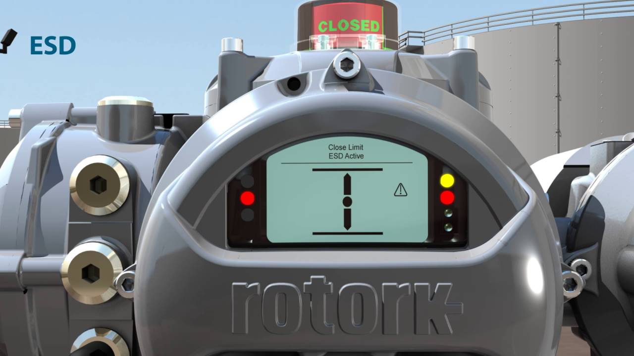

The latest development sees the introduction of the intelligent SI/EH Pro control and monitoring system, based on the well proven Rotork IQPro electric actuator. SI/EH Pro actuators provide a new level of control and functionality for Remote Operated Shut-off Valve (ROSoV) applications by combining existing features with new text displays, performance monitoring and data logging that includes the valve signature profiles.
Non-intrusive setting, commissioning and data communication - all benchmark features of Rotork’s IQPro actuation technology - in combination with an intrinsically safe BluetoothTM setting tool, enables actuator configuration and data logger files to be transferred from the field to the office for download, analysis and storage.
Schematic diagram of solenoid valves
The setting tool enables safe and rapid non-intrusive commissioning by means of easy to follow ‘point and shoot’ menus. Settings such as internal hydraulic pressure, position, limits, control options, alarm and indication functions can be accessed and adjusted. Actuator status, control and alarm icons are viewable on the illuminated LCD display which also provides access to real-time information including pressure, diagnostics and help screens.

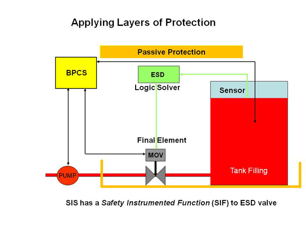

Layers of protection applied to ROSoV duty
In this example, a Safety Instrumented System (SIS) is applied to prevent overfilling of a tank.
The tank and pump are controlled by the BPCS (Basic Process Control System) and the installation is physically contained within a bund. The signal from the level sensor is feeding back to the PLC in the BPCS which controls the pump and the MOV. A fault with the level sensor leaves the tank vulnerable to overfilling, as was the case at Buncefield.
To account for this, the SIS is added, consisting of a separate level sensor and an ESD logic solver to control the MOV, which is the final element under the control of the SIS. The ESD signal is independent to other control signals and secures the valve in the safe position, providing a Safety Instrumented Function (SIF) for the Remote Operated Shut-off Valve (ROSoV) duty.
