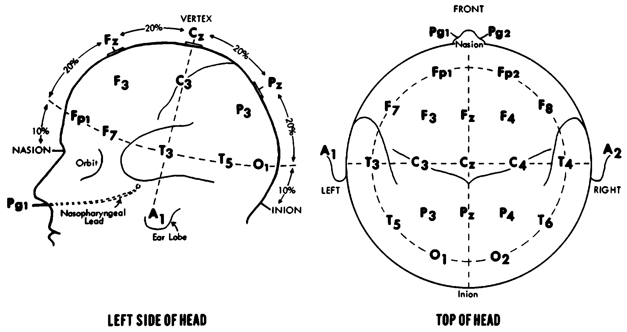

- The head is marked at four standard points nasion(nose), inion(back head) & left & right preauricular points(ears).
- Nineteen electrodes plus one for grounding is used.
- For EEG the electrodes are placed at 10%,20%, 20%, 20% and 10% from inion to nasion along lenght.

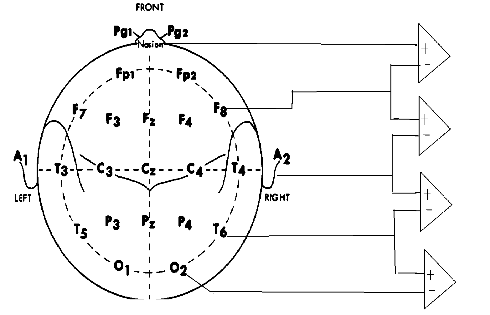

- Electrode is made either unipolar or bipolar form.
- Unipolar contains scalp-leads connected to common point like ear lobes.
- A bipolar scheme is available by interconnecting scalp electrodes.
Unipolar EEG recording mode:

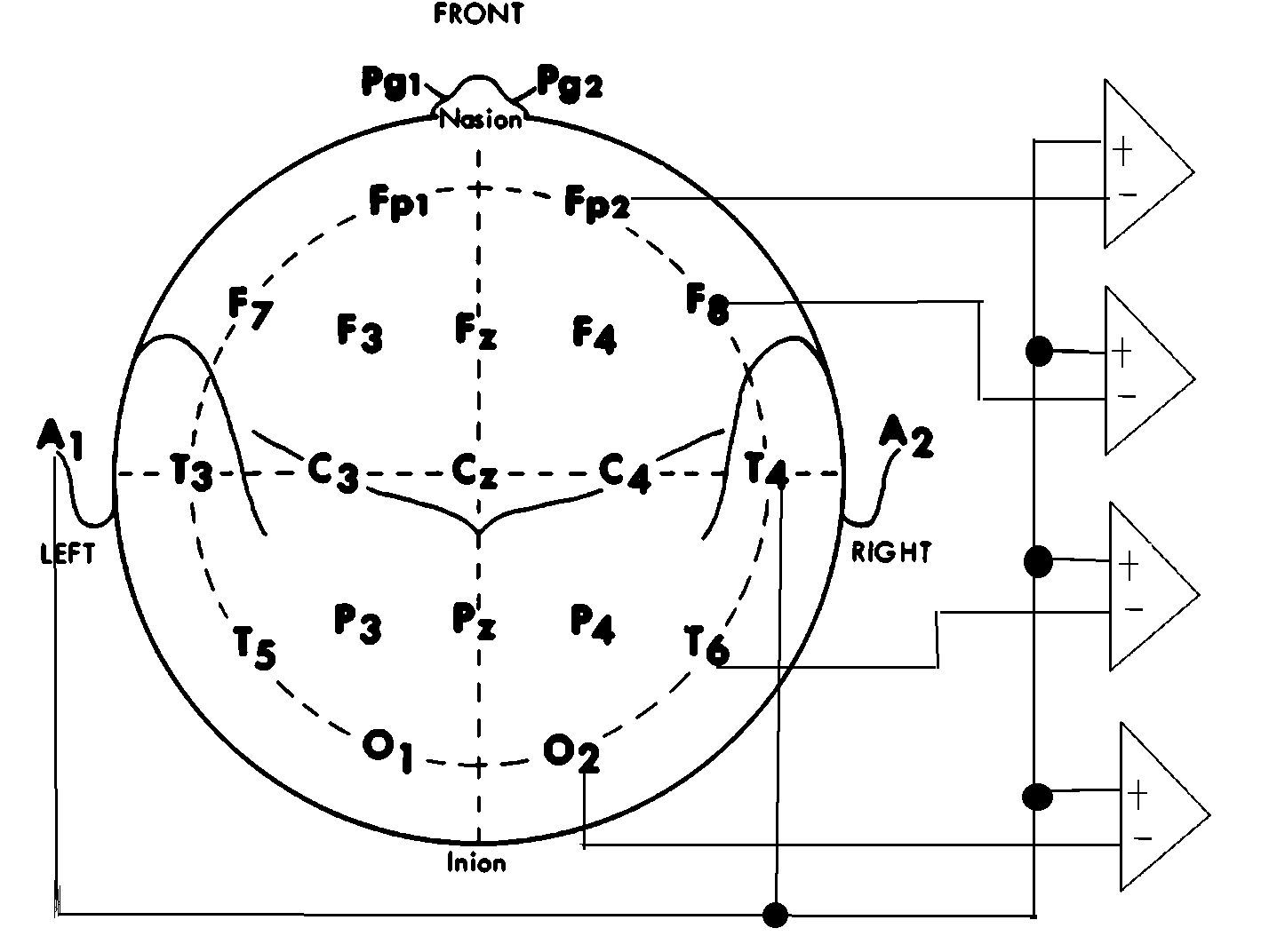

Bipolar EEG recording mode:

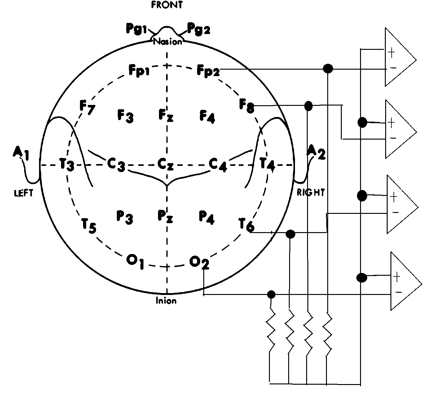

Average EEG recording mode:
