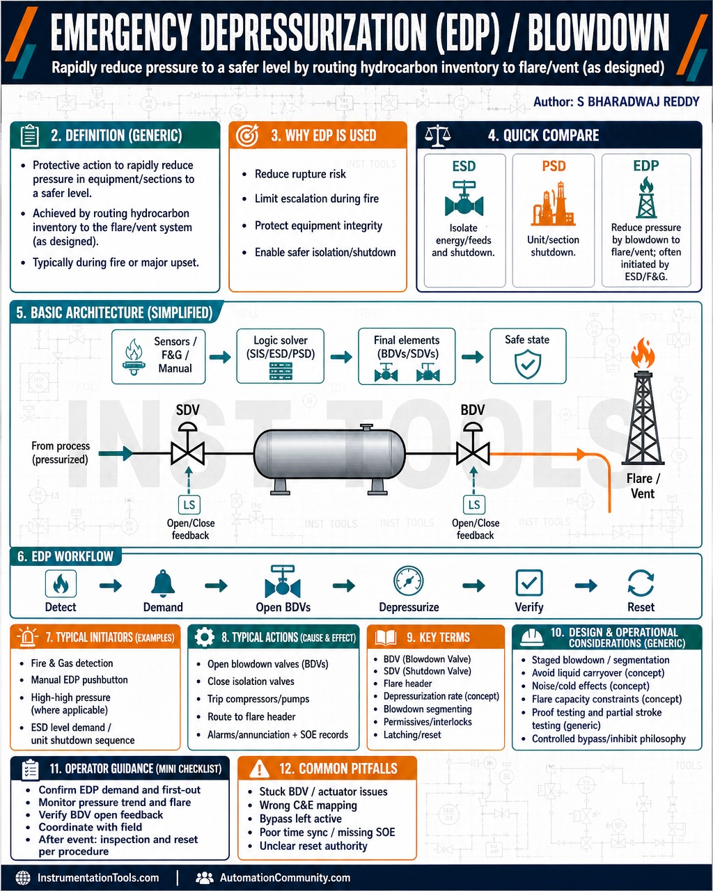

:police_car_light::dashing_away: EMERGENCY DEPRESSURIZATION (EDP): Rapidly Reducing Pressure During an Emergency! :shield::factory:
Imagine a hydrocarbon vessel or process system is exposed to a fire.
:fire: Fire β†’ Equipment heats up β†’ Pressure rises
If the pressure continues increasing, the equipment could eventually be exposed to a serious overpressure and loss-of-containment risk.
:backhand_index_pointing_right: This is where Emergency Depressurization (EDP) can play an important role.
:small_blue_diamond: What is Emergency Depressurization?
Emergency Depressurization (EDP) is a safety action that rapidly reduces the pressure in a process system by intentionally releasing or routing process fluids to a designated safe disposal system, typically through a depressurization/blowdown valve.
In simple terms:
:police_car_light: Emergency detected β†’ EDP initiated β†’ Blowdown valve opens β†’ Pressure decreases β†’ Risk reduced
:factory: Typical EDP Arrangement
A simplified system may look like:
ESD / Fire & Gas System
:down_arrow:
:brain: SIS / ESD Logic Solver
:down_arrow:
:unlocked: BDV – Blowdown Valve
:down_arrow:
:fire: Flare / Safe Disposal System
When the approved EDP conditions are met:
:police_car_light: Emergency condition
:down_arrow:
:brain: ESD logic initiates depressurization
:down_arrow:
:unlocked: Blowdown valve opens
:down_arrow:
:dashing_away: Process inventory is released to the designated disposal system
:down_arrow:
:chart_decreasing: Pressure decreases
:fire: Example: Fire Around a Pressure Vessel
Suppose a vessel contains hydrocarbons under high pressure.
A fire is detected nearby:
:fire: Fire detected
:down_arrow:
:police_car_light: ESD initiated
:down_arrow:
:locked: Inlet/outlet isolation performed as required
:down_arrow:
:unlocked: Emergency depressurization valve opens
:down_arrow:
:dashing_away: Gas routed to flare
:down_arrow:
:chart_decreasing: Vessel pressure decreases
The objective can include reducing the pressure and inventory exposed to the emergency, thereby helping reduce the consequences of the event.
:gear: EDP vs ESD
These are related but not the same function.
:red_circle: ESD β€” Emergency Shutdown
Primarily:
:backhand_index_pointing_right: Stop/isolate the process or equipment
Example:
ESD β†’ Close shutdown valves β†’ Isolate equipment
:dashing_away: EDP β€” Emergency Depressurization
Primarily:
:backhand_index_pointing_right: Reduce pressure by controlled depressurization
Example:
EDP β†’ Open blowdown valve β†’ Route inventory to flare β†’ Reduce pressure
In some plant philosophies, EDP is initiated as part of the overall ESD sequence.
:vs_button: EDP vs Pressure Relief Valve
Another important distinction:
Pressure Relief Valve (PSV/PRV):
:right_arrow: Normally responds automatically when its pressure setpoint is reached to protect against overpressure.
Emergency Depressurization:
:right_arrow: Is an engineered emergency action that intentionally depressurizes a system, often following detection of a fire or another defined emergency scenario.
Therefore:
:police_car_light: EDP is not simply a replacement for a PSV.
The pressure-protection and depressurization functions are determined by the overall process safety and relief-system design.
:wrench: Important EDP Components
A typical EDP function may involve:
:satellite_antenna: Emergency detection
:brain: ESD/SIS logic solver
:unlocked: Blowdown/depressurization valve
:high_voltage: Solenoid valve
:chart_decreasing: Pressure monitoring
:fire: Flare or disposal system
:locked: Isolation valves
The exact arrangement depends on the facility design.
:warning: Why Is EDP Important?
Emergency depressurization can help:
:white_check_mark: Reduce process pressure
:white_check_mark: Reduce the inventory exposed to an emergency
:white_check_mark: Reduce potential consequences of fire exposure
:white_check_mark: Reduce the severity of a potential loss-of-containment event
:white_check_mark: Help move the process toward a safer condition
But it must be carefully engineered because rapid depressurization can also introduce hazards such as:
:snowflake: Low-temperature effects
:dashing_away: High discharge rates
:fire: Flare loading
:gear: Mechanical/thermal stresses
:ocean: Two-phase flow or liquid carryover
Therefore, the depressurization rate, valve sizing, flare capacity, and downstream effects must be properly evaluated.
:bullseye: Interview Question
What is Emergency Depressurization (EDP)?
:backhand_index_pointing_right: Emergency Depressurization is a safety function that intentionally and rapidly reduces the pressure of a process system during a defined emergency by opening a depressurization/blowdown path, typically routing the released inventory to a flare or other designated safe disposal system.
:light_bulb: Remember:
:red_circle: ESD β†’ Stop / Isolate
:dashing_away: EDP β†’ Depressurize
:fire: PSV β†’ Protect against overpressure
:shield: EDP is not about controlling normal pressureβ€”it is an emergency protection function designed to reduce the consequences of specific hazardous scenarios.
