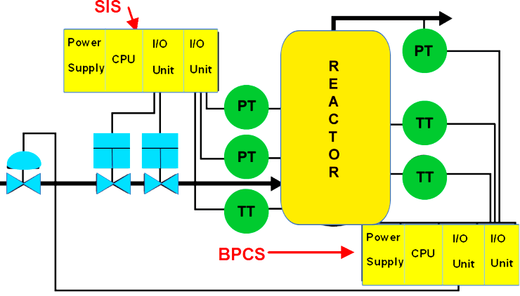

In industrial facilities there are often hardwired and dedicated safety shutdown systems that are designed to vent/flare hydrocarbons, stop equipment, de-energize equipment, etc., when an emergency or upset condition has occurred.
This hardwired safety shutdown system is the last automated control layer before the physical protection devices such as PSVs operate to protect against a catastrophic loss.
Emergency Shutdown System
