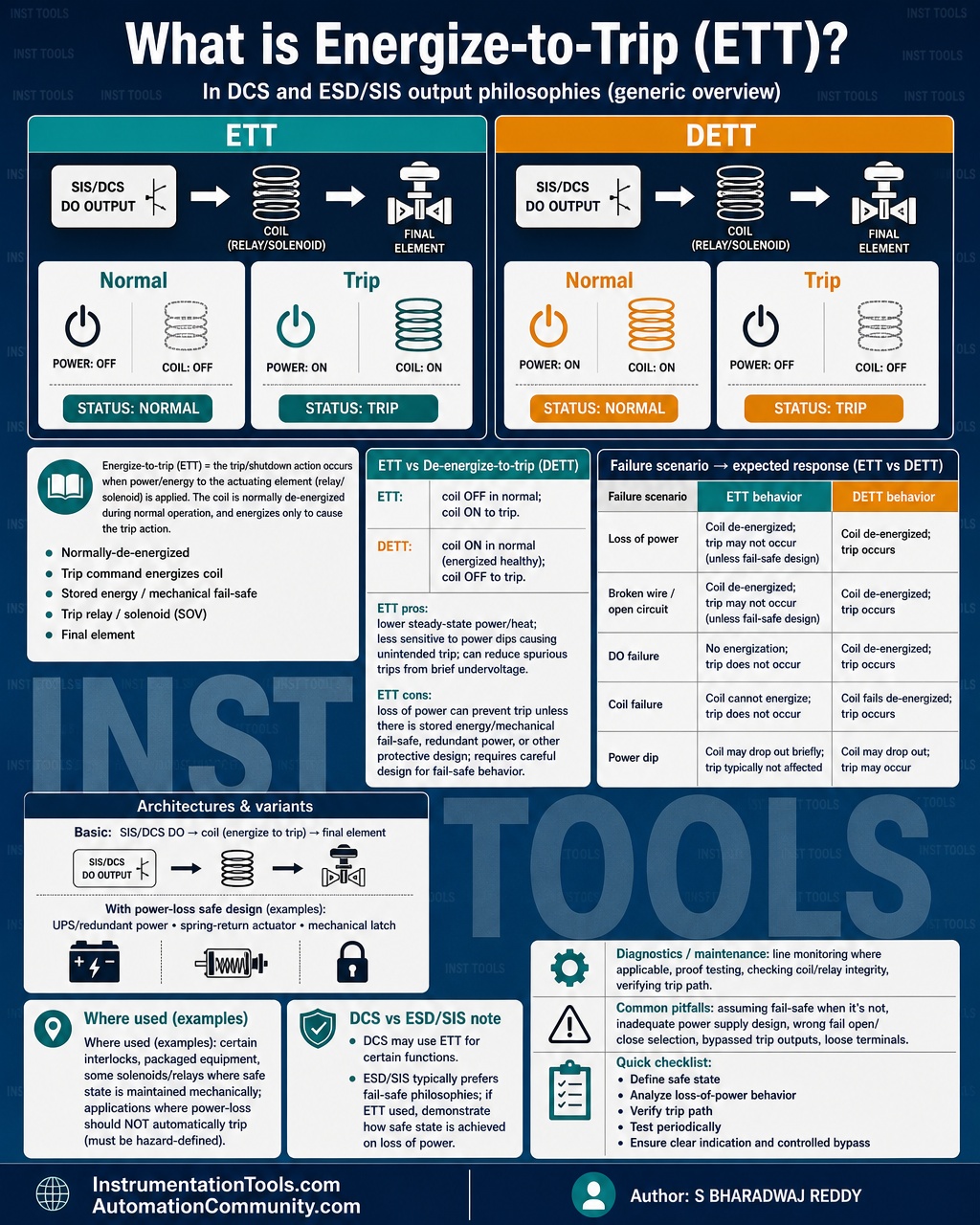

Energize-to-trip (ETT)
:high_voltage::police_car_light: ENERGIZE-TO-TRIP (ETT): When the Safety System Sends Power to Cause a Trip! :shield:
In an Energize-to-Trip (ETT) philosophy, the safety action is initiated by energizing the trip circuit.
In simple terms:
:high_voltage: Energize β†’ Trip
:small_blue_diamond: How Does ETT Work?
Consider a shutdown solenoid valve:
ESD Logic β†’ Output β†’ Solenoid β†’ Shutdown Valve
Under normal operation:
:green_circle: Solenoid de-energized
:down_arrow:
:green_circle: Process equipment operates
When a trip condition occurs:
:police_car_light: Trip detected
:down_arrow:
:high_voltage: ESD output energizes
:down_arrow:
:electric_plug: Solenoid energizes
:down_arrow:
:locked: Shutdown valve moves to its trip position
:down_arrow:
:shield: Process moves toward the safe state
:factory: Simple Example
Suppose a compressor must trip when:
High-High Discharge Pressure
occurs.
Normal condition:
HH Pressure = FALSE
:down_arrow:
ETT output = OFF
Trip condition:
HH Pressure = TRUE
:down_arrow:
ETT output = ON :high_voltage:
:down_arrow:
Trip circuit energizes
:down_arrow:
:stop_sign: Compressor trips
:warning: The Major Disadvantage of ETT
Consider a failure in the trip circuit:
:electric_plug: Broken wire
:down_arrow:
:cross_mark: No current can reach the trip device
But the system may interpret this as:
:green_circle: No trip
So certain faults can remain undetected unless additional diagnostics are provided.
This is one reason De-Energize-to-Trip (DTT) is widely used for many process shutdown applications.
:vs_button: ETT vs DTT
Energize-to-Trip :high_voltage: De-Energize-to-Trip :electric_plug:
Energy is applied to initiate trip Energy is removed to initiate trip
Normal state generally energized/de-energized depending on design Typically trip circuit energized during healthy operation
Trip requires energization Trip occurs when circuit de-energizes
Loss of power may not automatically cause trip Loss of power can initiate trip
Some circuit faults may not be inherently fail-safe Can provide a fail-safe response to loss of energy
:fire: Simple Memory Trick
:high_voltage: ETT
Energize = Trip
:electric_plug: DTT
De-energize = Trip
:warning: Important Functional-Safety Point
ETT is not automatically unsafe, and DTT is not automatically safe.
The correct trip philosophy depends on:
:small_blue_diamond: Hazard analysis
:small_blue_diamond: Safe-state requirements
:small_blue_diamond: Final-element design
:small_blue_diamond: Failure modes
:small_blue_diamond: Diagnostic coverage
:small_blue_diamond: Spurious-trip requirements
:small_blue_diamond: Process operating conditions
:small_blue_diamond: SIS architecture
:small_blue_diamond: Applicable functional-safety requirements
For example, some applications may intentionally use energize-to-trip where the process and safety analysis justify it.
:bullseye: Interview Question
What is Energize-to-Trip (ETT)?
:backhand_index_pointing_right: Energize-to-Trip is a trip philosophy in which the safety system initiates the specified shutdown action by energizing the trip circuit or final element.
:light_bulb: Remember:
:high_voltage: ETT = Energize β†’ Trip
:electric_plug: DTT = De-energize β†’ Trip
:police_car_light: The key question in safety design is not simply β€œETT or DTT?”—it is whether the selected philosophy provides the required safety integrity and appropriate response to credible failures.
