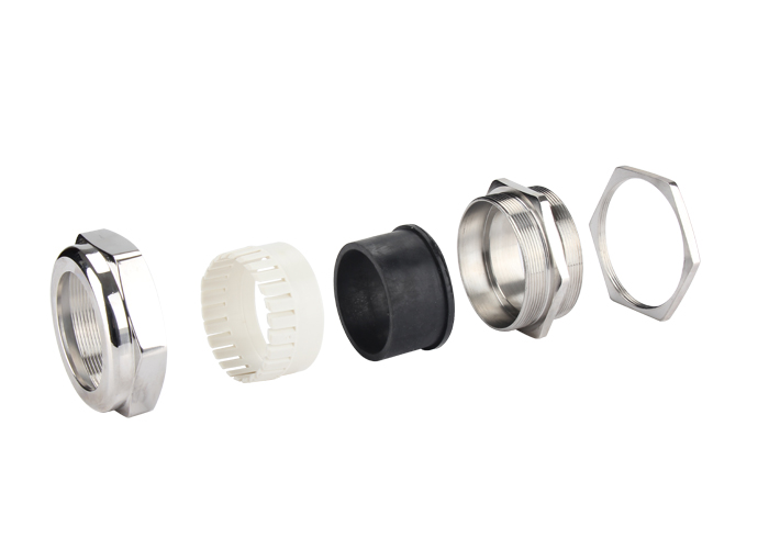

Cable gland is a cable fitting used for cable penetration into the equipment and make secure connection between cable and the equipment.
Cable gland also provides several functions in cable installation as follows:
As a cable strain-relief
To seal the equipment form surrounding ambient hence maintaining the characteristic of the equipment. The explosion proof equipment/panel shall have Eexd certified cable gland to make the explosion proof protection does not void
provision for making electrical connection to the mechanical protection i.e. armour or braid

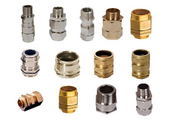

The selection of cable gland shall consider several following factors:
Material, the enviromental condition and particle that cable gland might be exposed to
Size, depends on the intended cable size/diameter
Type of protection, Eexd/Eexe or general purpose
Cable type to be attached, armored/non-armoured
The required Degree of Ingress protection
