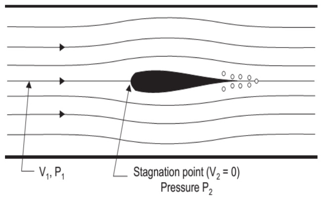

Consider Fig. which shows flow around a solid body. When a solid body is held centrally and stationary in a pipeline with a fluid streaming down, due to the presence of the body, the fluid while approaching the object starts losing its velocity till directly in front of the body, where the velocity is zero.
This point is known as the stagnation point.
As the kinetic head is lost by the fluid, it gains a static head.
By measuring the difference of pressure between that at normal flow line and that at the stagnation point, the velocity is found out.
This principle is used in pitot tube sensors.
