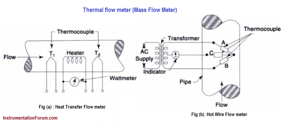

CONSTRUCTION AND WORKING
A schematic diagram of a heat transfer flowmeter is shown in Fig. (a), which consists of an electric immersion heater for the heating of flowing fluid.
Two thermocouples (or resistance thermometers) TI and T2 are placed at each side of the heater as in Fig (a).
The thermocouple TI measures the temperature of fluid before it is heated, while the thermocouple T2 measures the temperature so after.
The power supply to the heater equals the heat transferred to the fluid, i e. Q, and is measured by a wattmeter. Thus by measuring the values of Q, TI and T2 the flow rate W of liquid is determined from the above equation.

Hot-Wire Flow meters
This type of flowmeter measures the effect of the flowing fluid on a hot body.
A hot-wire flowmeter consists of two thermocouples, A and B, connected in series to form a thermopile.
A third thermocouple C is placed in the output circuit of the thermopile, as shown in Fig. (b). The thermopile is heated by passing an alternating current to it.
The alternating current does not pass through the third thermocouple and it is therefore not electrically heated.
The whole assembly is placed into the fluid (usually gas) stream whose flow rate is to be determined. The fluid (gas) cools the heated thermopile by convection, and since the input power to the thermopile is held constant, the thermopile attains an equilibrium temperature and produces an emf that is a function of the temperature of the gas, velocity of the gas, and its density, specific heat, and thermal conductivity.
The third thermocouple (unheated) attains the ambient temperature of the gas, generating an emf that is proportional to the gas temperature and which cancels the effect of the ambient gas temperature on the output signal of the heated thermopile.
