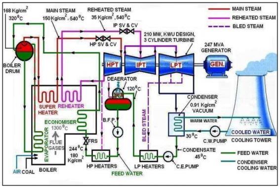

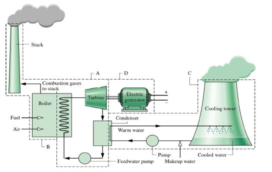

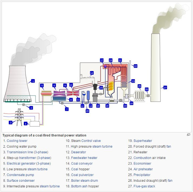

Schematic of a Thermal Power Plant
Figure 01: Rankine Cycle and Thermal Power Plants
Figure 02: Schematic of a Thermal Power Plant-2

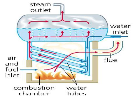

Water Tube boilers
In this boiler, the water flows inside the tubes and hot gases flow outside the tube .
Water tube boiler are classified as
Vertical tube boiler
Horizontal tube boiler
Inclined tube boiler
The circulation of water in the boiler is may be natural or forced.
Figure 09: Water Tube Boiler

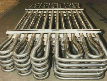

Economizer
Boilers are provided with economizer and air pre-heaters to recover heat from the flue gases. An increase of about 20% in boiler efficiency is achieved by providing both economizer and air pre-heaters.
Economizer alone gives only 8% efficiency increase. The feed water from the high pressure heaters enters the economizer and picks up heat from the flue gases after the low temperature superheater.
Economizer can be classified as an inline or staggered arrangement based on the type of tube arrangement.
Figure 13: Economizer

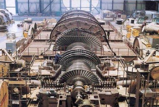

Steam Turbines
Steam entering from a small opening attains a very high velocity. The velocity attained
during expansion depends on the initial and final content of the steam.
The difference in initial and final heat content represent the heat energy to be converted to
kinetic energy.
There are two types of steam turbines:
Compounding of steam turbines:
Single stage turbines are of low efficiency.
In compounding, a number of rotors are connected or keyed to the same shaft
Two types of compounding are used: velocity compounding and pressure compounding
Governing of steam turbines:
Governing signifies the process of controlling the volume of steam to meet the load fluctuation.
Figure 15: Steam Turbine
Figure 16: Steam Turbine
Figure 17: Steam Turbine
