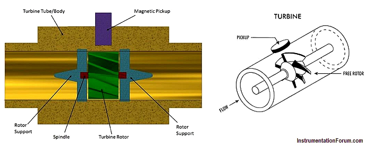

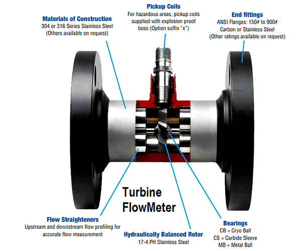

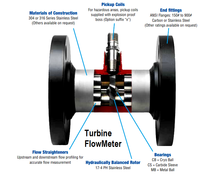

Construction:
- It consists of a multi-bladed rotor (turbine wheel) which is mounted at right angles to the axis of the flowing liquid, as shown in Fig.
- The rotor is supported by ball or sleeve bearings on a shaft which is retained in the flowmeter housing by a shaft-support section. The rotor is free to rotate about its axis.
Working:
- The flowing fluid impinges on the turbine blades (rotor), imparting a force to the blade surface which causes the rotation of the rotor.
- The speed of rotor is directly proportional to the fluid velocity, and hence to volumetric flow rate when it is at a steady rotational speed.
- The speed of rotation is monitored in most of the meters by a magnetic pickup coil, which is fitted to the outside of the meter housing.
- The magnetic-pickup coil consists of a permanent magnet with coil windings which is mounted in close proximity to the rotor but internal to the fluid channel.
- As each rotor blade passes the magnetic-pickup coil, it generate a voltage pulse which is a measure of the flow rate, and the total number of pulses give a measure of the total flow.
- The electrical voltage pulses can be totalled; subtracted and manipulated by digital techniques so that a zero error characteristic of digital handling is provided from the pulse generator to the final read out.
