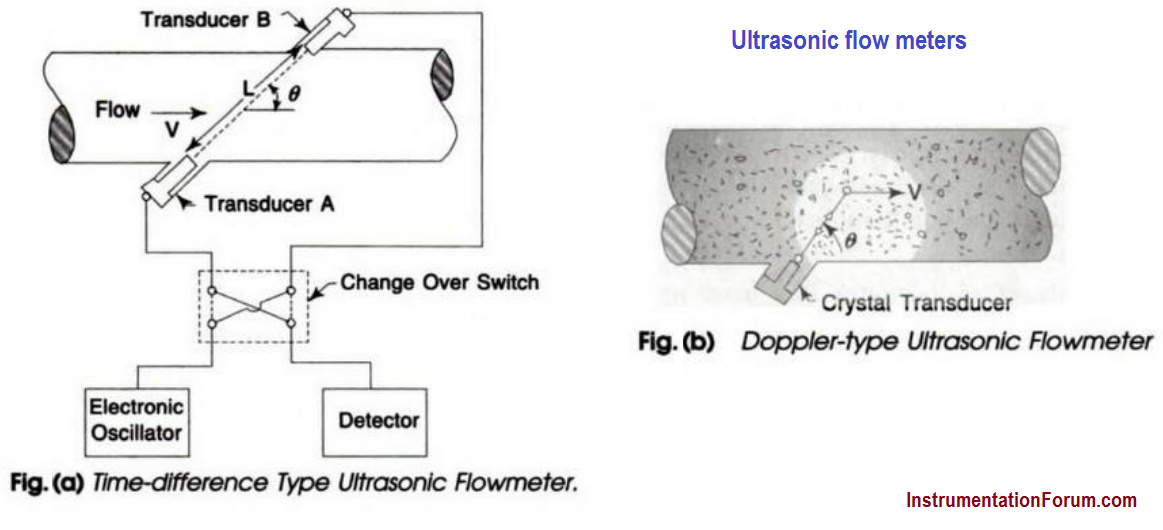

Types of Ultrasonic Flow Meters
- Transit time flow meters
- Doppler Flow meter.

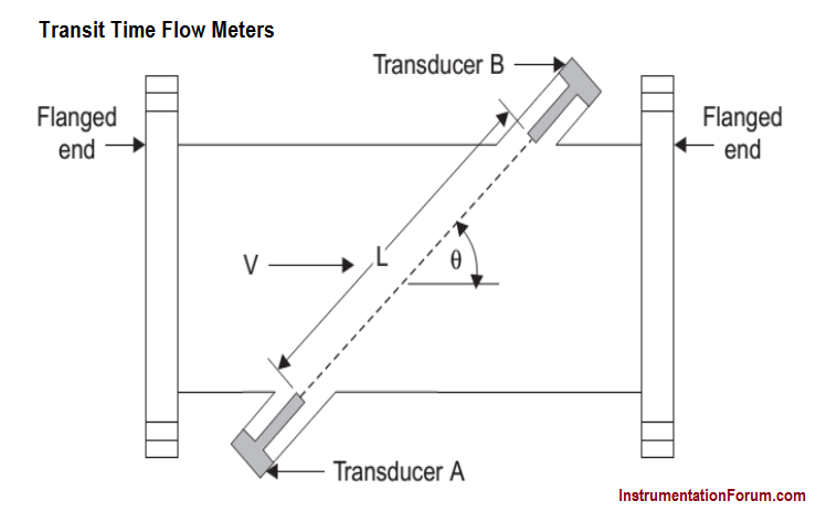

Transit Time Flow Meters
As the name implies these devices measure flow by measuring the time taken by an ultrasonic energy pulse to traverse a pipe section, both with and against the flow of the liquid within the pipe. Fig. 1 shows a transit time flow meter.
The time (tAB) for the ultrasonic energy to go from transducer A to transducer B is given by the expression:
tAB = L/(C + V. cos θ)
The time (tBA) to go from B to A is given by
tBA = L/(C – V.cos θ)
where C is the speed of sound in the fluid, L is the acoustic path length in the fluid,
θ is the angle of the path with respect to the pipe axis.
By combining and simplifying, it can be shown that for V << C :
∆t = tBA – tAB = 2.L.V. cos θ/C
It can be shown that :
V = C.∆t/2 L cos θ
Since the cross sectional area of the pipe section or ‘spool pipe’ is known, the product of area and velocity will yield the volumetric flow rate.
Doppler Flow Meters
This type of flow meter is based on Doppler principle.
The transmitter of a Doppler flow meter projects an ultrasonic beam at a frequency of about 0.5 MHz into the flowing stream and deflects the reflected frequency.
The difference between transmitted and reflected velocities is called the ‘beat frequency’ and is related to the velocity of the reflecting surfaces (solid particles and gas bubbles) in the process stream.

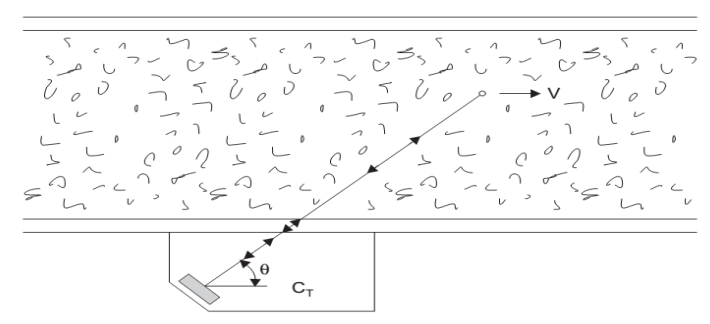

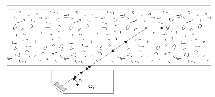

Principle of Operation
As shown in Fig.3, an ultrasonic wave is projected at an angle through the pipe wall into the liquid by a transmitting crystal in a transducer mounted outside the pipe.
Part of the energy is reflected by bubbles or particles in the liquid and is returned through the pipe wall to a receiving crystal.
If the reflectors are travelling at the fluid velocity, the frequency of the reflected wave is shifted according to the Doppler principle, in proportion to the flow velocity.
Combining Snell’s law and Doppler equation, the flow velocity can be determined as follows if V << C.
V = ∆f.Ct /(2.fo .cos θ) = ∆f.K
where ∆f = Difference between transmitted and received frequency, fo= frequency of transmission, Ct = Velocity of sound in the transducer. θ = angle of the transmitter and receiver crystal with respect to the pipe axis,
As shown in equation, velocity is a linear function of ∆f. Since the inside diameter (ID) of the pipe is known, volumetric flow rate can be measured as a function of V and square of ID
