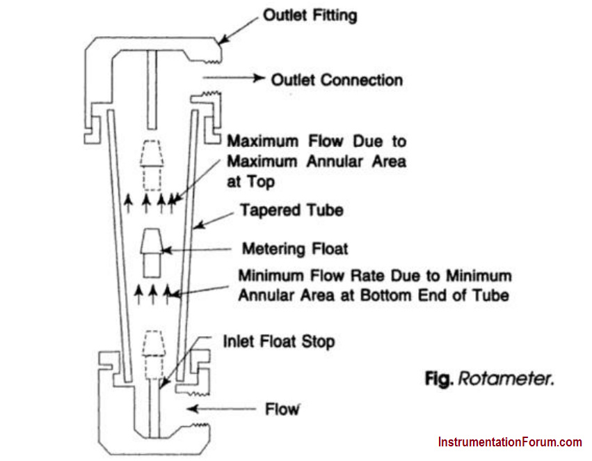

When fluid or gas flows through a taper tube containing a float, a pressure difference is created between upper and lower side of the float.
The float moves upwards by a force obtained by multiplying the pressure differential by the maximum cross sectional area of the float.
Variable area meter : Rotameter
Due to taper tube, as the float moves upwards, the fluid passing area increases because of which the differential pressure decreases. Upward movement of float stops when the differential pressure dynamically balances the dead load.
Tapering of metering tube is so designed that the vertical movement of the float becomes linearly proportional to the rate of flow and the scale is provided to read the position of the float, thus it gives flow rate indication.

Construction:
A rotameter consists of a tapered tube, typically made of glass with a āfloatā.
Float is made of anodized aluminum or a ceramic and it moves freely inside the glass tube.
Floats will be pushed up by the drag force of the flow and pulled down by gravity.
The drag force for a given fluid and float cross section is a function of flow speed squared only.
A higher volumetric flow rate through a given area increases flow speed and drag force, so the float will be pushed upwards.
However, as the inside of the rotameter is cone shaped (widens), the area around the float through which the medium flows increases, the flow speed and drag force decrease until there is mechanical equilibrium with the floatās weight.
Working:
The position of float inside the glass tube is measured using appropriate scale or tube itself have scale printed on it. This height of the float can be calibrated in terms of the flow rate.
Floats are made in many different shapes, with spheres and ellipsoids being the most common.
The float may be diagonally grooved and partially colored so that it rotates axially as the fluid passes. This shows if the float is stuck since it will only rotate if it is free.
Readings are usually taken at the top of the widest part of the float; the center for an ellipsoid, or the top for a cylinder. Some manufacturers use a different standard.
