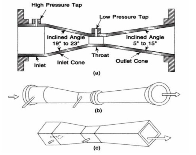

Venturi tube
Figures -
a) long-form or classic venture tube
b) Eccentric form
c) rectangular form
Construction:
A venturi tube is used where permanent pressure loss is of prime importance, and where maximum accuracy is desired in the measurement of high viscous fluids.
It consists of
a straight inlet section of the same diameter as the pipe in which the high pressure tap is located,
a converging conical inlet section in which the cross-section of the stream decreases and the velocity head and decrease of pressure head,
a cylindrical throat which provides for the low pressure tap location of the decreased pressure in an area where flow velocity is neither increasing nor decreasing, and
a diverging recovery cone in which velocity decreases and the decreased velocity head is recovered as pressure head, as shown in Figure 1.
The pressure taps are located one-quarter to one-half pipe diameter up-stream of the inlet cone and at the middle of the throat section.

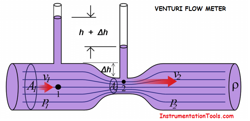

Working:
The function of the different size cones is to produce differential pressure inside the tube, which can be connected to the secondary pressuremeasuring device.
This will measure the differential pressure produced by the tube. This pressure difference can be calibrated in terms of flow rate.

The venturi tubes are usually made of cast iron or steel, and are built in several forms such as
(i) long-form or classic venturi tube.
(ii) short-form where the outlet cone is shortened,
(iii) an eccentric form to minimize the built up of heavy material and a
(iv) rectangular form used in air duct-work.
