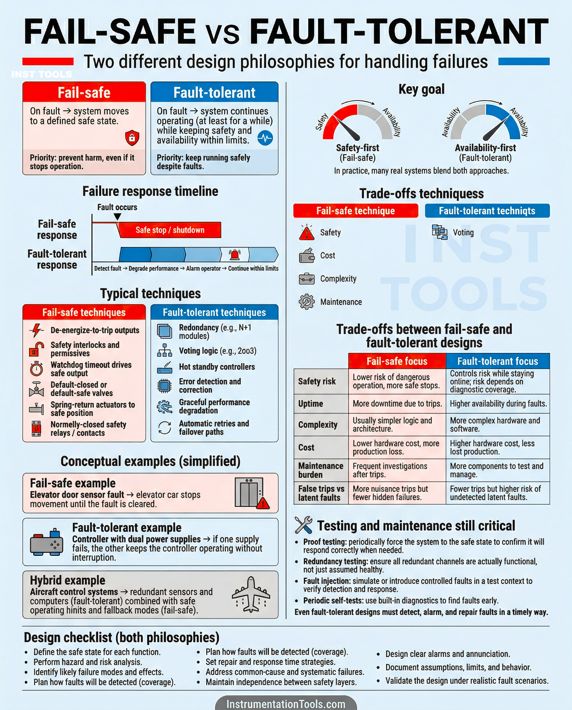

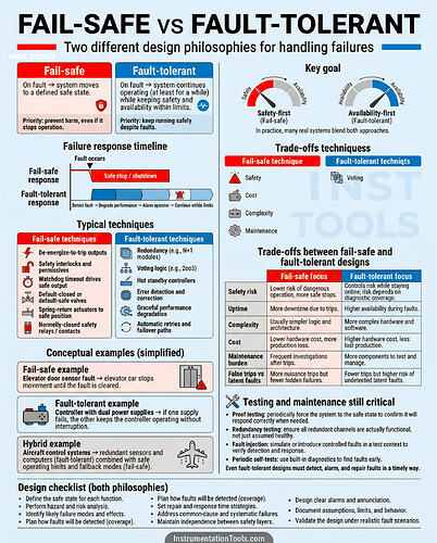

:stop_sign: Fail-Safe System
:right_arrow: Designed to go to a safe state when failure occurs
:brain: Example:
:small_blue_diamond: Power loss → Valve closes
:small_blue_diamond: Signal failure → System trips
:high_voltage: Prioritizes safety over operation
:warning: Process may stop
:backhand_index_pointing_right: Goal: Prevent accidents
:green_circle: Fault-Tolerant System
:right_arrow: Designed to continue operation even if a failure occurs
:brain: Example:
:small_blue_diamond: One controller fails → Others keep running
:small_blue_diamond: One sensor fails → System still works
:high_voltage: Uses redundancy (1oo2, 2oo3, TMR)
:high_voltage: Maintains system availability
:backhand_index_pointing_right: Goal: Avoid interruption
:brain: Key Differences
:small_blue_diamond: Fail-Safe → Stops system safely
:small_blue_diamond: Fault-Tolerant → Keeps system running
:small_blue_diamond: Fail-Safe → No redundancy required
:small_blue_diamond: Fault-Tolerant → Requires redundancy
:small_blue_diamond: Fail-Safe → Focus on safety
:small_blue_diamond: Fault-Tolerant → Focus on availability + reliability
:backhand_index_pointing_right::backhand_index_pointing_right: WATCH VIDEO:
:factory: Where used
:stop_sign: Fail-Safe → Safety PLC, SIS, ESD systems
:green_circle: Fault-Tolerant → DCS, critical control systems, servers
:bullseye: Simple understanding
:backhand_index_pointing_right: Fail-Safe = Stop safely when failure happens
:backhand_index_pointing_right: Fault-Tolerant = Continue working despite failure
:light_bulb: Best systems use both concepts together for maximum safety and reliability
