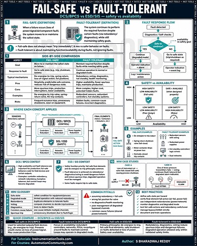

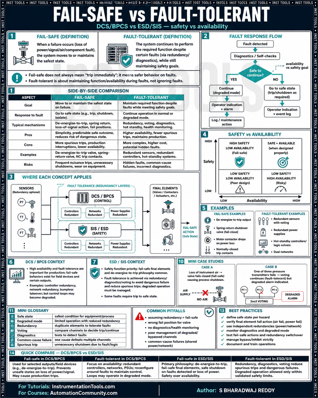

FAIL-SAFE vs FAULT-TOLERANT
:police_car_light::gear: FAIL-SAFE vs FAULT-TOLERANT: Two Concepts Every Automation Engineer Should Know! :shield:
These terms sound similar, but they solve different problems.
:small_blue_diamond: FAIL-SAFE
Fail-safe means that when a specified failure or loss of required energy occurs, the system is designed to move to or maintain a predefined safe state.
In simple words:
:warning: Failure occurs β†’ System goes to the defined safe condition
:factory: Example: Shutdown Valve
Suppose a process must be isolated if instrument air is lost.
A pneumatically actuated shutdown valve may be designed as:
Air failure β†’ Valve closes :locked:
This is commonly called:
:backhand_index_pointing_right: Fail Close (FC)
The valve is designed so that loss of the required actuating energy results in the intended safe position.
Other possibilities include:
:locked: Fail Close
:unlocked: Fail Open
:pause_button: Fail in Place
The correct fail position depends on the process hazard and safety requirements.
:shield: FAULT-TOLERANT
Fault-tolerant means a system is designed to continue performing its required function despite certain specified faults.
In simple words:
:warning: Fault occurs β†’ System continues operating
:desktop_computer: Example: Redundant PLC
Consider two redundant controllers:
:green_circle: Primary Controller
:green_circle: Standby Controller
If the primary controller fails:
:red_circle: Primary fails
:down_arrow:
:counterclockwise_arrows_button: Standby takes over
:down_arrow:
:green_circle: Control continues
The system has tolerance to the specified controller fault.
:vs_button: FAIL-SAFE vs FAULT-TOLERANT
Fail-Safe :police_car_light: Fault-Tolerant :shield:
Focuses on achieving/maintaining a safe state after a specified failure Focuses on continuing the required function despite specified faults
Failure may cause shutdown Failure may not cause shutdown
Safety is the primary objective Availability/continuity is a primary objective
Example: Valve closes on loss of air Example: Redundant controller continues operation
May intentionally stop the process Attempts to keep the process operating
:fire: Simple Industrial Example
Imagine a cooling-water pump system.
Fail-Safe Approach:
Pump failure β†’ Safety function β†’ Process moves to a safe condition.
:police_car_light: Priority = Safety
Fault-Tolerant Approach:
Pump A fails β†’ Pump B automatically takes over.
:counterclockwise_arrows_button: Priority = Continued operation despite the fault
:warning: Important Point
Fail-safe does NOT mean β€œthe equipment can never fail.”
It means the system is designed so that specified failures lead to a defined safe response.
Likewise:
Fault-tolerant does NOT mean β€œthe system cannot fail.”
It means the system can continue performing its intended function despite specified faults.
:bullseye: Interview Question
What is the difference between fail-safe and fault-tolerant?
:backhand_index_pointing_right: Fail-safe: A specified failure causes the system to move toward a predefined safe state.
:backhand_index_pointing_right: Fault-tolerant: The system continues to perform its required function despite specified faults.
:light_bulb: Easy memory trick:
:police_car_light: FAIL-SAFE β†’ β€œFail and become SAFE.”
:shield: FAULT-TOLERANT β†’ β€œFault occurs, but keep OPERATING.”
And in real SIS/ESD design, these concepts can work togetherβ€”for example, a redundant safety system can tolerate certain faults while still being designed to achieve the required safe state when a dangerous condition occurs.
