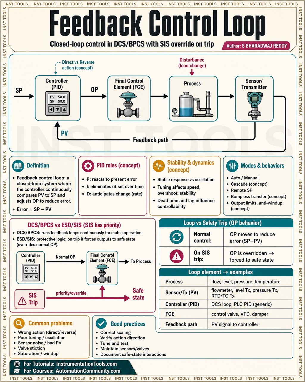

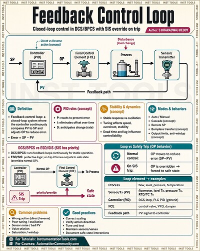

Feedback Control Loop
Imagine you want to maintain a tank level at 60%.
But the actual level changes because the outlet flow changes.
How does the system automatically correct the level?
:backhand_index_pointing_right: Feedback control!
:small_blue_diamond: What is a Feedback Control Loop?
A feedback control loop is a control system in which the actual process output is measured and fed back to the controller, which compares it with the desired setpoint and adjusts the manipulated variable to reduce the error.
In simple terms:
:bullseye: Measure → Compare → Correct → Measure Again
:counterclockwise_arrows_button: Basic Feedback Loop
Setpoint (SP)
:down_arrow:
:brain: Controller
:down_arrow:
:control_knobs: Final Control Element
:down_arrow:
:factory: Process
:down_arrow:
:satellite_antenna: Sensor / Transmitter
:down_arrow:
:counterclockwise_arrows_button: Feedback to Controller
The controller continuously compares:
Setpoint − Process Variable = Error
The controller then uses this error to determine the required control action.
:factory: Example: Tank Level Control
Suppose:
:bullseye: Setpoint = 60%
Actual level:
:thermometer: PV = 50%
Therefore:
:chart_decreasing: Error = 10%
The controller may increase the inlet valve opening:
50% → 65% → 75%
More liquid enters the tank.
The level rises:
50% → 55% → 59% → 60%
:bullseye: The controller continuously adjusts the valve based on the measured level.
:control_knobs: Main Components
A typical feedback control loop contains:
:one: Setpoint (SP)
The desired process condition.
:two: Measurement / Transmitter
Measures the actual process variable.
:three: Controller
Compares SP and PV and calculates the control action.
:four: Final Control Element
Acts on the process—for example, a control valve or VFD.
:five: Process
The physical system being controlled.
:high_voltage: Why Is Feedback Important?
Without feedback, the controller does not know the actual process result.
With feedback:
:thermometer: Process changes
:down_arrow:
:satellite_antenna: Measurement detects change
:down_arrow:
:brain: Controller calculates error
:down_arrow:
:control_knobs: Control action changes
:down_arrow:
:factory: Process responds
:down_arrow:
:counterclockwise_arrows_button: Measurement is repeated
This allows the system to automatically compensate for disturbances and process changes.
:vs_button: Open Loop vs Feedback Control
Open Loop:
:backhand_index_pointing_right: No feedback
:backhand_index_pointing_right: Controller does not measure the actual output for correction
Feedback Control:
:backhand_index_pointing_right: Feedback is present
:backhand_index_pointing_right: Actual output is measured
:backhand_index_pointing_right: Controller corrects the error
:bullseye: Interview Question
What is a feedback control loop?
:backhand_index_pointing_right: A feedback control loop measures the actual process output, compares it with the desired setpoint, and uses the resulting error to adjust the manipulated variable so that the process moves toward the desired condition.
:light_bulb: Remember:
SP → Compare → Controller → FCE → Process → Measurement → Feedback :counterclockwise_arrows_button:
:bullseye: The controller doesn’t just give the process a command—it checks what actually happened and corrects it.
#FeedbackControl #ControlLoop #PID #ProcessControl #Instrumentation dcs #PLC #SCADA #IndustrialAutomation #ControlSystems Automation #ControlEngineering #InstrumentationEngineer #ProcessControl :factory::gear::counterclockwise_arrows_button:
